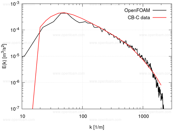

An initial velocity field was created using the createBoxTurb utility. This is based on the procedure described by Saad et. al. [65], using the turbulence energy spectra at \( t^*= 42 \).
An animation for a 256x256x256 box showing the velocity field, and turbulence structures using the Q criterion shows the decay of the complex flow field.
An example of the decay profiles for the WALE LES model shows good agreement.
WALE 128x128x128 |
The grey region represents the wave numbers above the Nyquist limit for this mesh.
