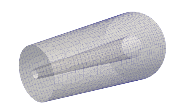

A cone, optionally hollow
cone
type searchableCone;
point1 (0 0 0);
radius1 1.5;
innerRadius1 0.25;
point2 (10 0 0);
radius2 3.0;
innerRadius2 1.0;
Where:
| Property | Description | Required |
point1 | Axis point at the start | yes |
radius1 | Outer radius at the start | yes |
innerRadius1 | Inner radius at the start | yes |
point2 | Axis point at the end | yes |
radius2 | Outer radius at the end | yes |
innerRadius2 | Inner radius at the end | yes |
