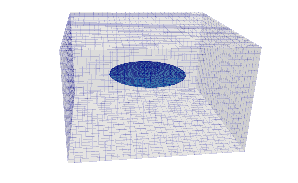

A disk with zero thickness based its origin, normal direction and radius.
disk
type searchableDisk;
origin (0 0 0);
normal (0 1 0);
radius 0.314;
Where:
| Property | Description | Required |
origin | Disk origin | yes |
normal | Normal direction | yes |
radius | Disk radius | yes |
