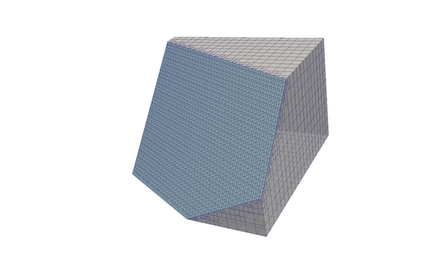

An infinite plane. The plane can be used to cut-out part of the domain, where the mesh in the plane normal direction will be preserved. The plane can be specified according to:
