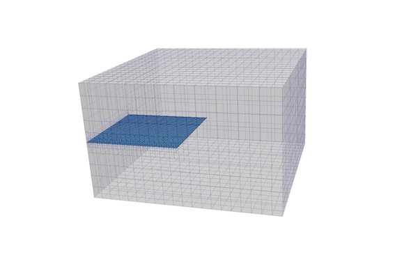

A finite plate aligned with co-ordinate system. User must specify span in two directions, the third must be zero. Plate could be used e.g. to create a baffle or measuring plane.
plane
type searchablePlate;
origin (0 0 0);
span (2 4 0);
Where:
| Property | Description | Required |
origin | Centre of plate | yes |
span | Span in each direction | yes |
Note that the span must have one 0 entry, e.g.
(1 1 0)(1 0 1)| Would you like to suggest an improvement to this page? | Create an issue |
