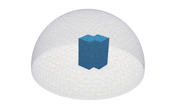

A set of transformed searchableSurfaces.
After creating the searchable object the searchableSurfaceCollection can be scaled and transformed in the specified local co-ordinate system.

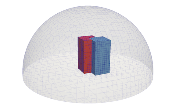

In the example shown here, the box1 has two copies called seal and herring. The geometries are always merged. Regions are merged when
mergeSubRegions true;
As it is shown in Figure 1. Figure 2 shows the situation with regions not merged.
box1
type searchableBox;
min (0 0 0);
max (1 1 1);
twoFridgeFreezers
type searchableSurfaceCollection;
mergeSubRegions true; //create single region
seal
surface box1;
scale (1.0 1.0 2.1);
transform
coordinateSystem
type cartesian;
origin (3 3 0);
coordinateRotation
type axesRotation;
e1 (1 0 0);
e3 (0 0 1);
herring
surface box1;
transform
coordinateSystem
type cartesian;
origin (2.5 2.5 0);
coordinateRotation
type axesRotation;
e1 (1 0 0);
e3 (0 0 1);
