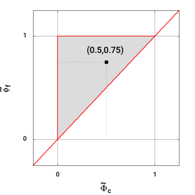

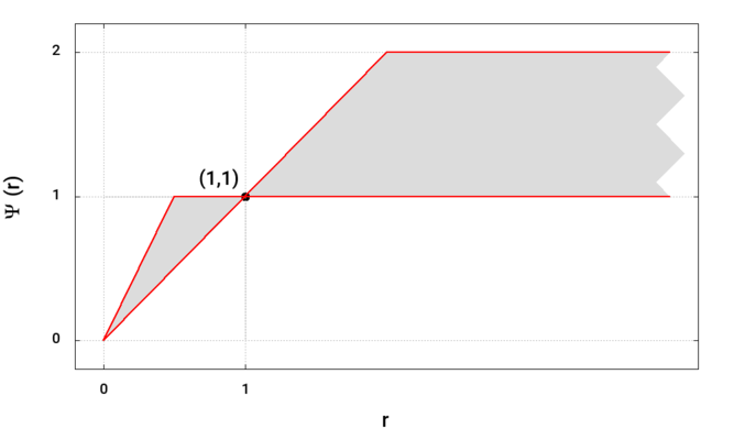

Many of the convection schemes in OpenFOAM are based on the Normalised Variable (NV) [44] and Total Variation Diminishing (TVD) [25] methods. These provide a set tools to characterise scheme properties such as boundedness (1-D).
NVD |
TVD |
For arbitrary unstructured meshes it is not straightforward to identify the upstream and downstream locations reliably. The limiters are evaluated using a compact stencil as described in Jasak et al. [28], where:
TVD: Limiter \(\Psi(r)\) defined as a function of \(r\)
\[ r = 2 \frac{\vec{d} \dprod \left( \grad{\phi} \right)_P}{\vec{d} \dprod \left(\grad{\phi} \right)_f} - 1 = 2 \frac{\vec{d} \dprod \left( \grad{\phi} \right)_P}{\phi_N - \phi_P} - 1 \]
NVD: Limiter \(\widetilde{\phi_f}\) defined as a function of \(\widetilde{\phi_c}\)
\[ \widetilde{\phi_c} = 1 - 0.5 \frac{\vec{d} \dprod \left( \grad{\phi} \right)_f}{\vec{d} \dprod \left( \grad{\phi}\right)_P } = 1 - 0.5 \frac{\phi_N - \phi_P}{\vec{d} \dprod \left(\grad{\phi}\right)_P} \]
