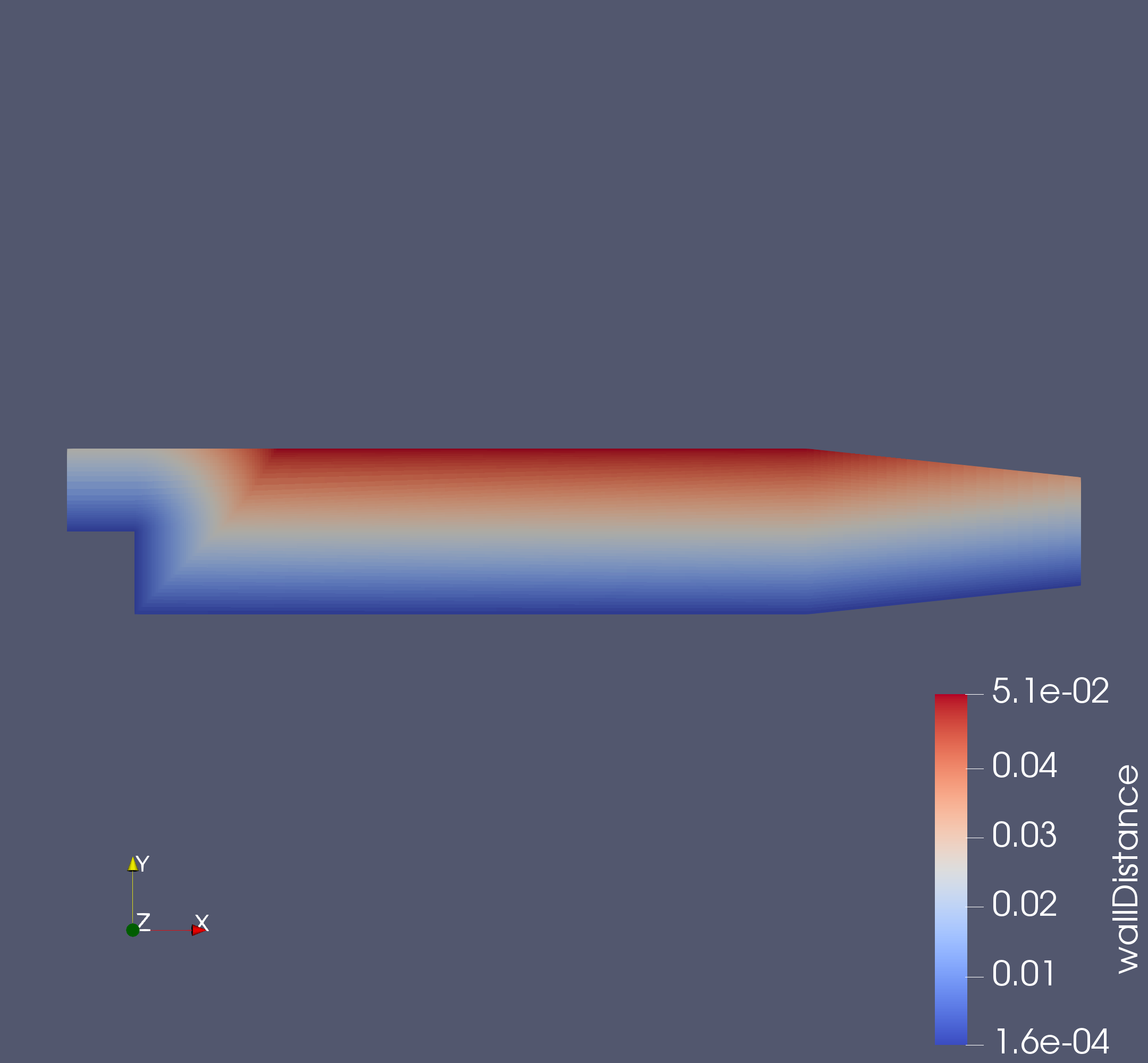

An example of meshWave output in terms of the wall distance can be seen as follows:
