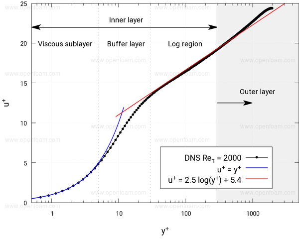

Effective use of turbulence models requires close attention to their respective meshing requirements, particularly in near-wall regions.
DNS data from Lee and Moser [42]
