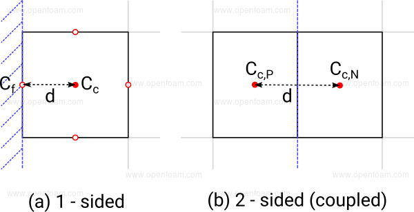

In the absence of sources and sinks, system behaviour is driven by its boundary conditions. These form a critical aspect of case specification where ill-posed combinations will lead to physically incorrect predictions, and in many cases, solver failure.
OpenFOAM offers a wide range of conditions, grouped according to:
Boundary conditions are assigned in the boundaryField section of the field files within each time directory for each mesh patch. The format follows:
boundaryField
<patch 1>
type <patch type>;
<patch 2>
type <patch type>;
<patch N>
type <patch type>;
Each condition is set in a dictionary given by the name of the underlying mesh patch, according to the type keyword.
