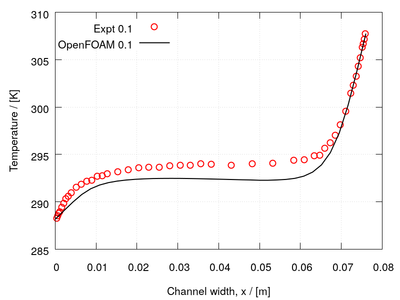

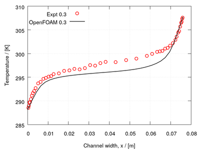

A temperature difference of 19.6K is maintained between the hot and cold; the remaining patches are treated as adiabatic.
Results are presented for a selection of y/H locations
