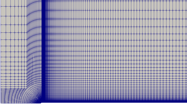

Mesh
2D structured mesh created using
blockMesh

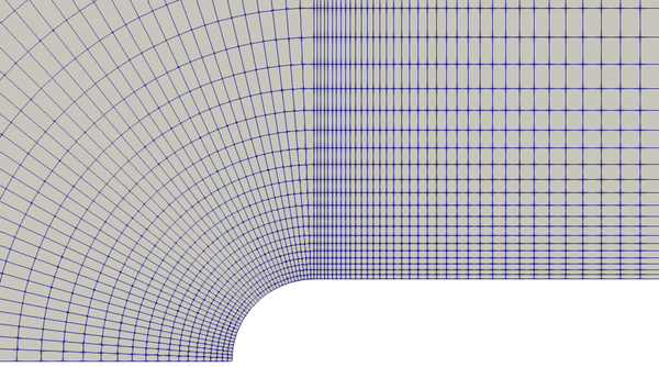

Mesh
Close-up around the step

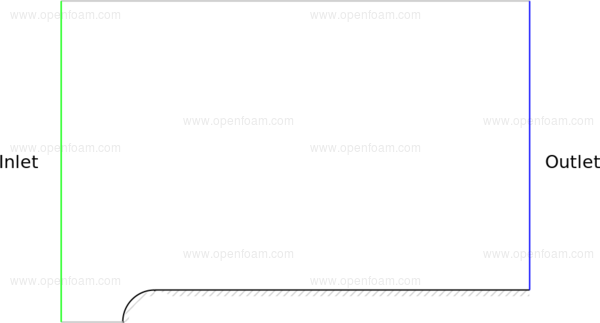

Boundary conditions
Ux: 5.4 m/s
Isotropic turbulence: 3.3 %
Viscosity ratio: 12
Fluid properties
Kinematic viscosity: 1.5e-5 m2/s

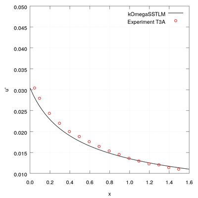

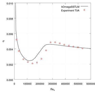

Results
Turbulence kinetic energy
Wall shear stress
