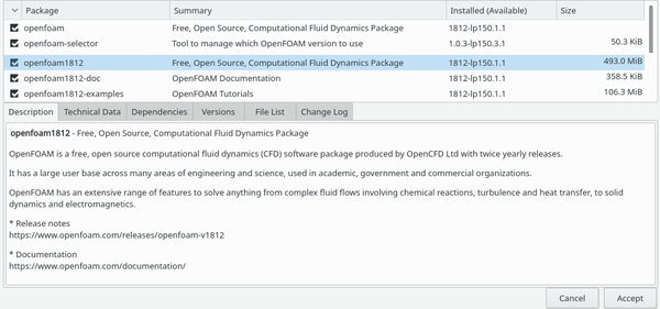

RPM Installation
For openSUSE users, OpenCFD Ltd. is working with the community Science Portal and the build service to provide OpenFOAM as precompiled RPM packages.
Simply go to the download page https://software.opensuse.org//download.html?project=science&package=openfoam2006 and follow the instructions there.
If you already have the Science repository registered on your system, you should be able to install it directly with dnf (Fedora) or zypper (openSUSE) or with graphical tools such as YaST2.
Note that the science repository also includes the latest versions of scotch and ParaView for using with OpenFOAM.
