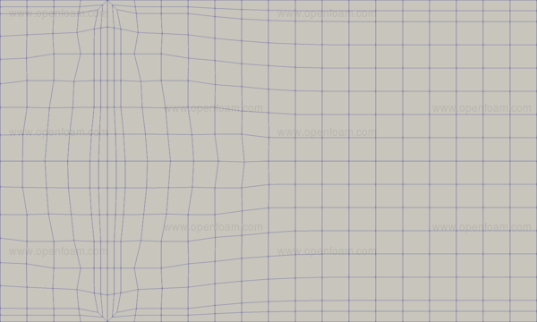

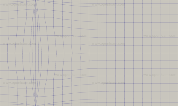

In below figures the effect (in v1806) of two feature angles is shown:
- 45 degrees i.e. disabling all extrusion in sharp angles
- 130 degrees, i.e. allowing extrusion in sharp angles)
![[Picture]](img/bug-fix-snappy-layer-feature-angle-1.png)
![[Picture]](img/bug-fix-snappy-layer-feature-angle-2.png)
