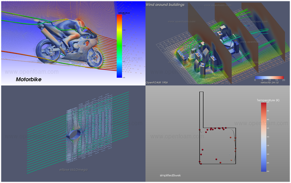

Improvements in runTimePostProcessing
The runTimePostProcessing function object provides a direct VTK insitu visualization alternative to the ParaView/Catalyst interface for well-defined, high throughput workflows.
![[Picture]](img/post-processing-run-time-pp.png)
The revised function object adds many new features:
- parallel VTK rendering
- rendering of sampled surfaces that are stored in memory without needing to serialize to a file format
- direct rendering of patches and clouds without an intermediate sampling stage
- can now render vector arrows at the face centres of sampled surfaces or mesh patches.
- for more visually appealing images, the new smooth option can be used, which applies a cell-to-point interpolation of the face data to provide a smoother appearance.
- direct use of the VTK cutting plane algorithm
- Tutorials
- $FOAM_TUTORIALS/lagrangian/coalChemistryFoam/simplifiedSiwek
$FOAM_TUTORIALS/incompressible/pimpleFoam/RAS/ellipsekkLOmega
$FOAM_TUTORIALS/incompressible/pisoFoam/LES/motorBike/motorBike
$FOAM_TUTORIALS/incompressible/simpleFoam/windAroundBuildings

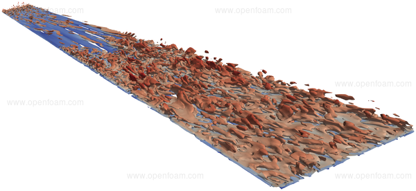

Plotting an iso-surface for the channel case shows that the resulting field is able to capture the turbulent content of the flow.
![[Picture]](img/post-processing-lamb-vector.png)

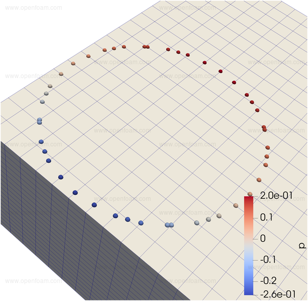

A new line sampling method, patchEdgeSet, samples values on patch edges that intersect a user-defined surface. The surface is of the generic searchablePlane type. Typical examples are plane or triSurfaceMesh (triangulated surface)
In below figure the pressure on the top patch has been sampled with a triangulated sphere.
![[Picture]](img/post-processing-patch-sampling.png)
