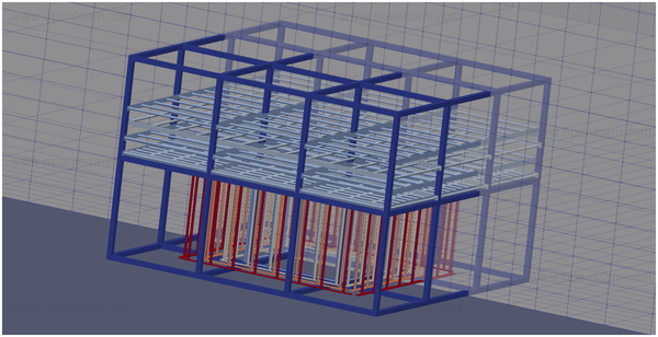

New set fields utility for PDRFoam
The new PDRsetFields utility computes the tensorial resistances of blockages for use by the PDRFoam solver. The geometry is input in the form of primitive shapes using a PDRsetFieldsDict file, taking the form:
// Replace by the relevant names
obsFileDir "<case>/geometry";
obsFileNames (obstaclesDict);
// legacyObsSpec true;
// obsFileNames (position.obs base.obs);
- cylinder
- diagonal beam
- cuboid
- grating
- louvre
- patch
An example set of obstacles is shown below:

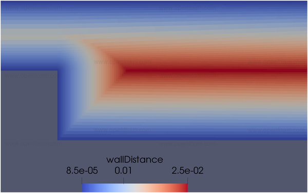

Wall distance output from checkMesh
The checkMesh utility option -writeAllFields has been extended to write the wall distance as a field wallDistance. It requir es the wall distance method to have been selected in system/fvSchemes dictionary:
method meshWave;

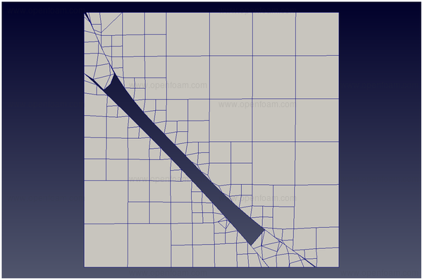

snappyHexMesh : automatic closure of thin gaps
In meshing complicated geometries there might be thin gaps where the user does not want a mesh. In this release snappyHexMesh allows a per-surface, per-surface-region specification of a blockLevel which specifies the minimum size of a gap to mesh. Any cell inside a gap smaller than this indicated size gets deleted (and consequently there will be no cells in the gap).
The extension is enabled using the following syntax:
"gap.*"
// Surface-wise min and max refinement level
level (2 2);
// From cell level 2 onwards start checking
// for opposite surfaces
blockLevel 2;
The blockLevel setting determines
- whether the surface is used at all in the gap detection
- an idealised size of the gap: 2 * cellsize; where cellsize is determined from the initial cell size refined blockLevel times
After all surface refinement snappyHexMesh but before any shell/volume refinement, determine for all cells the nearest two surfaces. If the cell is
- in between two surfaces, or disconnected regions of the same surface
- and the distance between the opposite points is less than the gap size
the cell will get deleted.
The tutorial opposite_walls is a simple block with two surfaces that form a thin gap.
![[Picture]](img/pre-processing-snappy-gap-closure.png)
