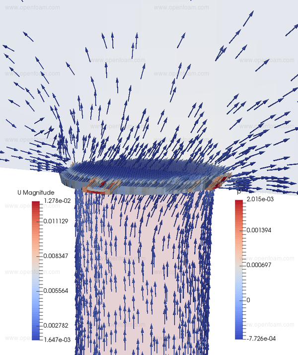

This source deflects the flow direction by imposing a variable pressure drop. This is particularly useful for cases that include louvres, e.g. HVAC registers, whereby to resolve the louvres using the mesh can lead to excessive cell counts and excessively restrict the calculation time step.
The pressure drop across the cellZone is evaluated according to the options:
cellZone should describe a set of cells with a 1-cell thickness in the flow directioncellZone to be specified as a faceZoneA sample result is shown below, where the effect of flow deflection across the cellZone is clearly evident.
