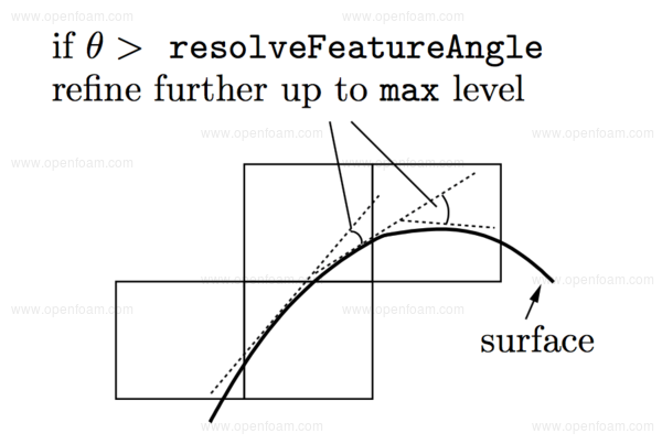

When the angle between the local surface normals is larger then the resolveFeatureAngle parameter, specified e.g. as
resolveFeatureAngle 60;
the mesh is refined to the Level specified by the second digit in the level dyad (see refinementSurfaces)

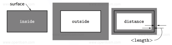

There are three modes of volumetric refinement:
inside
All cells whose cell centre lies within the box are refined. This box geometry must be closed. The first element in levels (the distance) is ignored; the second is the desired refinement level.
box
mode inside;
levels ((1.0 4));
outside
Same as inside but now the cells-to-be-refined are outside of the closed region.
box
mode outside;
levels ((1.0 4));
distance
All cells whose cell centre lies within a specified distance from the geometry are refined. The first argument in the levels dyad is the distance:
box
mode distance;
levels
(1.0 4) // within first 1.0 m refinement level 4
(2.0 3) // within 2.0 m refinement level 3.

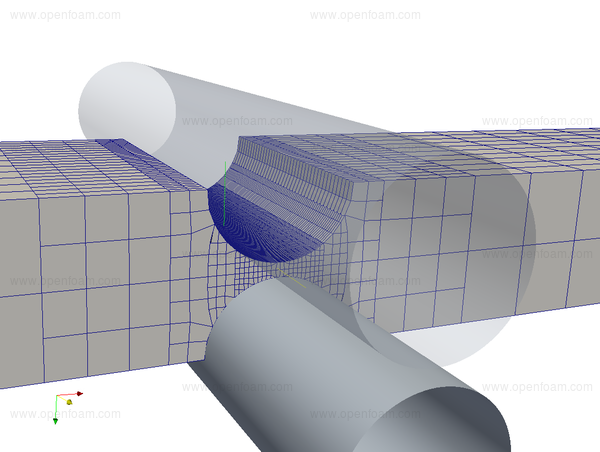

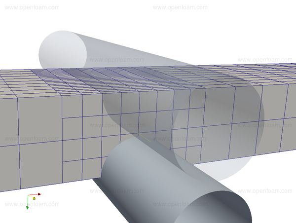

Activates gap level refinement. Takes three label arguments:
gapLevel (4 0 10);
Used in combination with gapMode
Gap refinement can directly remove cells based on orientation with respect to the gap. This limits the number of cells before performing the locationInMesh cell selection. Default is 'mixed' i.e. keep cells whilst doing the gap-level refinement.
gapMode outside; // inside|outside|mixed; default = mixed
The gapMode entry is applicable if the surface triangles are consistently oriented, i.e. all pointing out of the surface. This can be enforced by applying the surfaceOrient utility.
Used in combination with gapLevel
