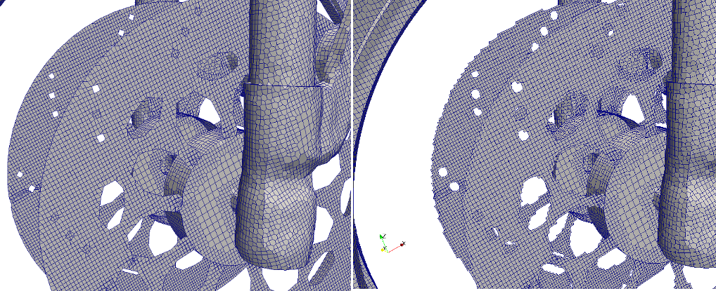

The mesh is snapped to the features after the surface snapping step. While during the surface snapping the points are displaced in the normal direction to the surface, displacement to the edge is more complicated. Therefore more iterations are typically needed.
Features may be specified explicitly using surfaceFeatureExtract utility which creates the eMesh file (located in constant/triSurface directory) with the feature line specification. Other option is to use implicit feature definition. In such case snappyHexMesh does not read eMesh file and defines the sharp edges itself. Implicit algorithm behaves correctly on simple meshes without sharp corners and baffles.
Figure shows the different result with explicit (left) and implicit (right) feature snapping. Picture shows mesh snapped on the baffle patches representing the break disks. Implicit snapping does not capture properly smooth edges.
