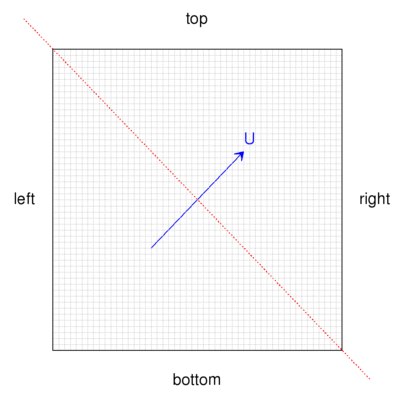

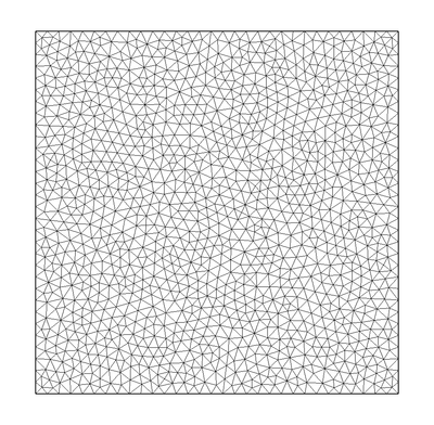

A 2-D square domain with side length 1m is employed, split into 50x50 uniform quad cells
Results are sampled at the location shown by the dashed line.

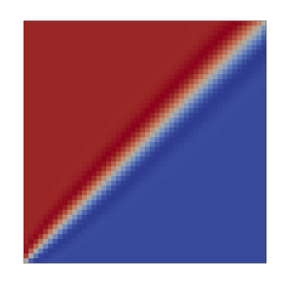

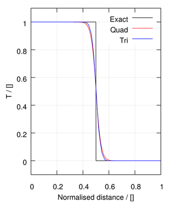

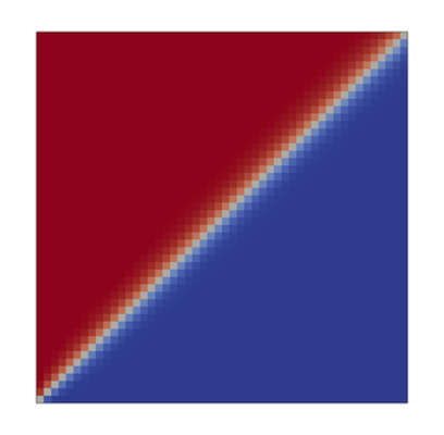

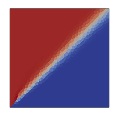

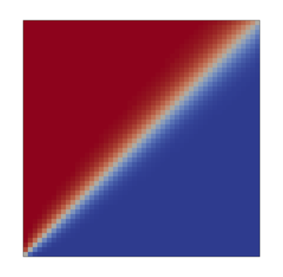

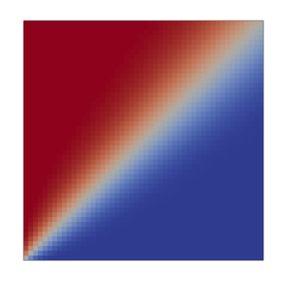

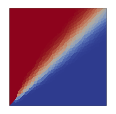

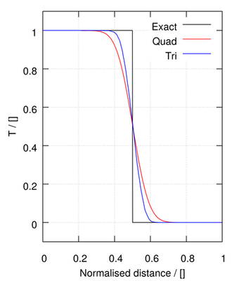

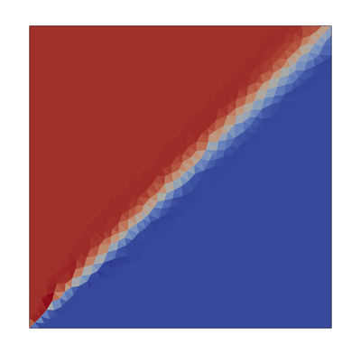

The following sequence of images show the steady results for the spatial distribution of the passive scalar. First order methods such as upwind show their diffusive characteristic, whereby the sharp profile is heavily smeared as the flow is not aligned with the mesh:
| upwind | ||

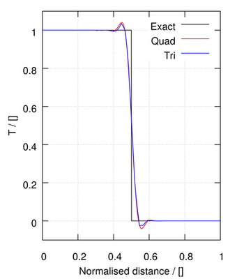

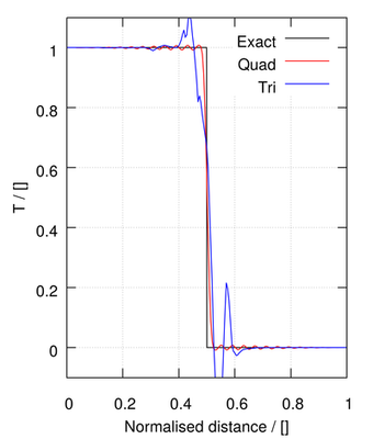

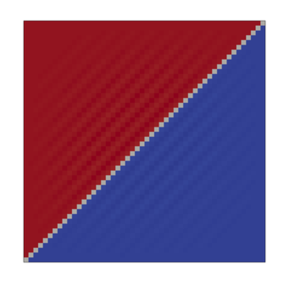

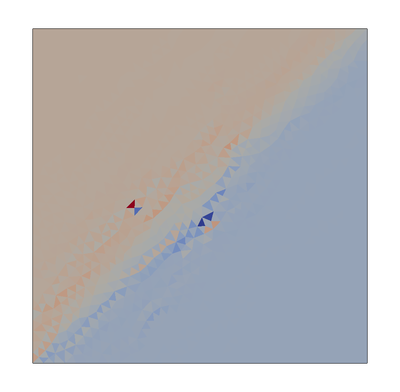

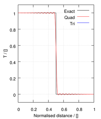

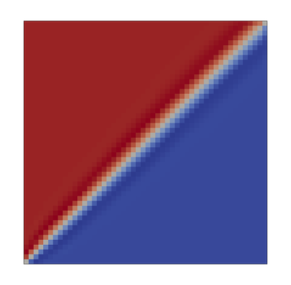

The linear scheme is a second order method, able to better preserve the step profile, but at the expense of unboundedness:
| linear | ||

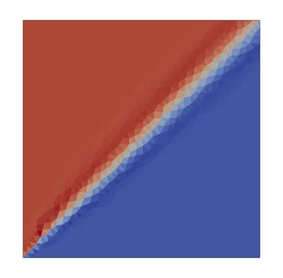

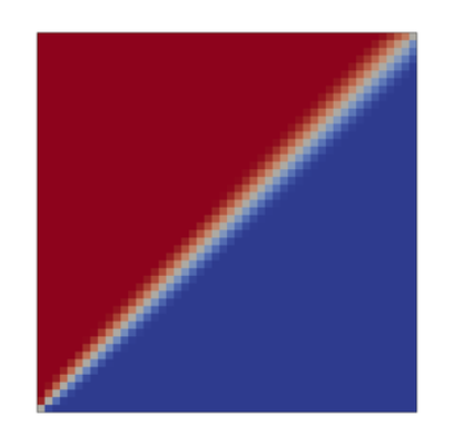

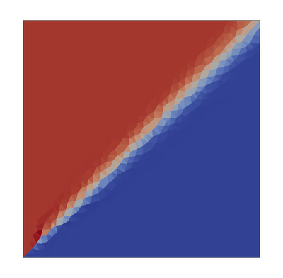

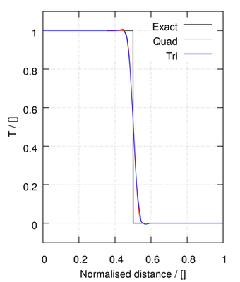

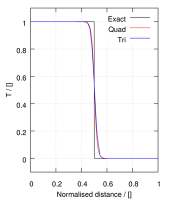

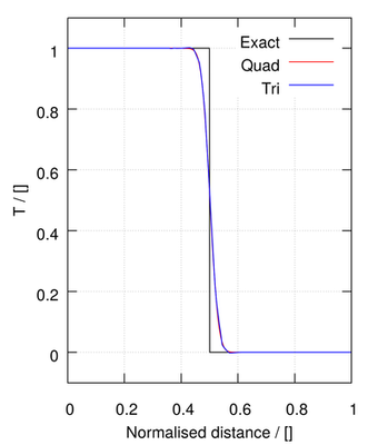

The remaining methods provide a blend between first order upwind and second order linear methods:
| Minmod | ||
| SFCD | ||
| limitedLinear 1.0 | ||
| vanLeer | ||
| MUSCL | ||
| midPoint - equivalent to linear on isotropic structured meshes | ||
| linearUpwind | ||
| QUICK | ||
