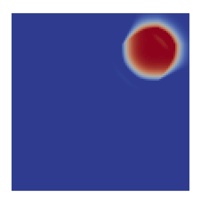

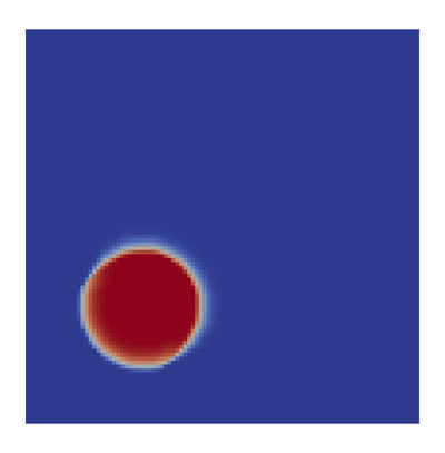

$FOAM_TUTORIALS/verificationAndValidation/schemes/timeExampleThe test case comprises a 2-D box section, across which a uniform flow is applied. A passive scalar is introduced in a circular region at the start time, and transported across the domain. By looking at the profile of the scalar across the section, we can determine the characteristics of our time scheme selection.
The impact of the choice of time scheme is assessed by varying the ddt scheme entry of the fvSchemes file:

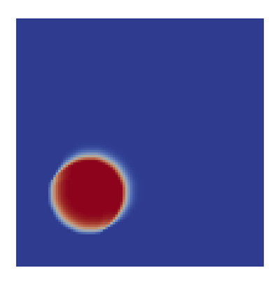

Time 1 |

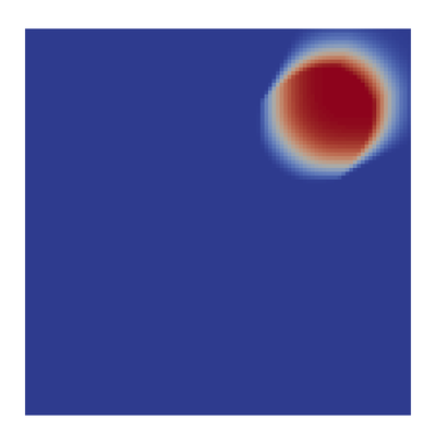

Time 2 |

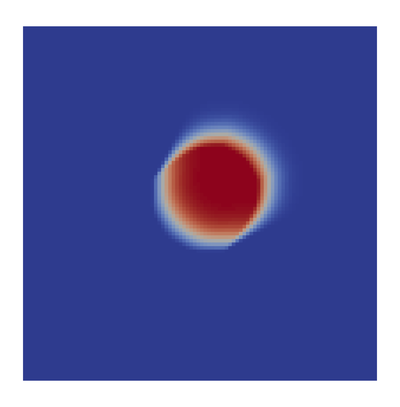

Time 3 |

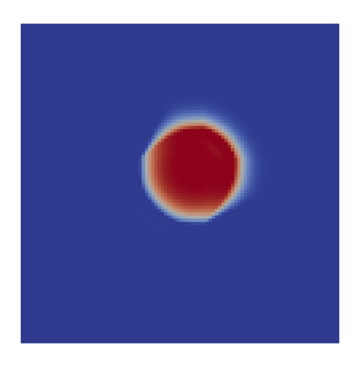

Time 1 |

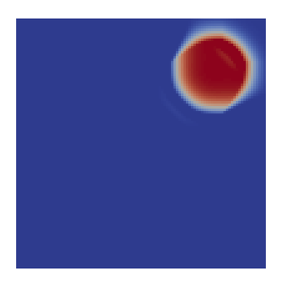

Time 2 |

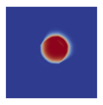

Time 3 |
Time 1 |
Time 2 |
Time 3 |
