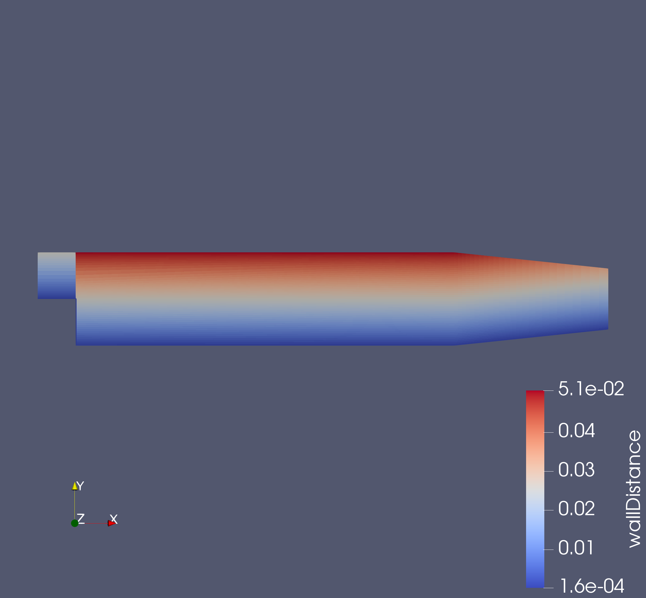

An example of directionalMeshWave output in terms of the wall distance can be seen as follows:
