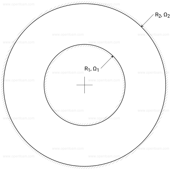

The case comprises two cylinders, with inner radius \( R_1 \) rotating with angular velocity \( \Omega_1 \), and outer radius \( R_2 \) rotating with angular velocity \( \Omega_2 \).
The laminar case corresponds to a Reynolds number of 100. where the Reynolds number os defined as:

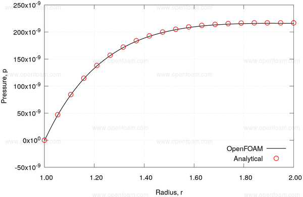

On integrating with respect to radius an expression for the pressure is recovered:
\[ p = \frac{A^2 r^2}{2} + 2 A B \ln (r) + \frac{B^2}{2 r^2} + C \]

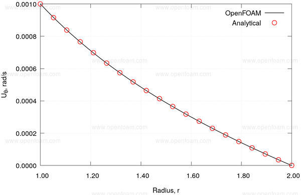

The rotational velocity, \( \u_\theta \) can be directly reported during the calculation using a fieldCoordinateSystemTransform function object.
Rotational velocity as a function of radius |
Pressure as a function of radius |
