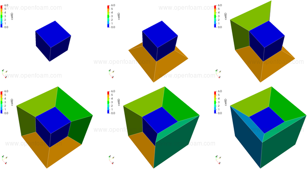

The new blockMesh -write-vtk option generates a blockTopology.vtu file (VTK, ASCII, XML) that can be loaded and inspected in ParaView, with its cell IDs equivalent to the block numbers. This provides a simple, robust method of inspecting blockMesh structures directly in any version of ParaView without the need for additional plugins.

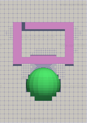

The geometry is a sphere (green) and a ’square’ with an (unwanted) gap (pink). With disabled ’self’ gap detection the mesh becomes (refinement only, no snapping):
![[Picture]](img/gapSelf_false.png)
No self-gap-refinement

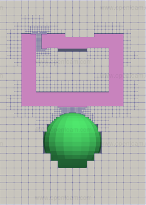

Compare this to the default method which due to the gap-refinement bleeds through the gap:
![[Picture]](img/gapSelf_true.png)
With self-gap-refinement
