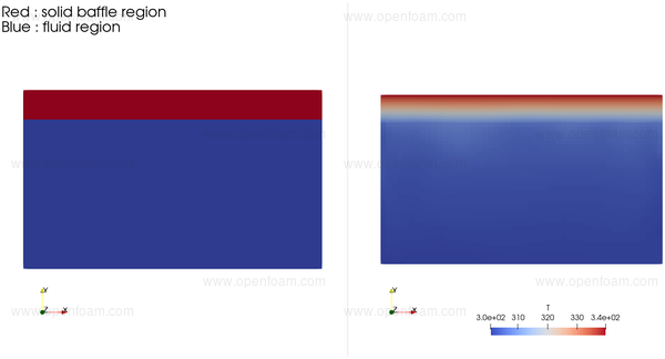

The following figure shows the main fluid and solid regions. Here, the solid region was extruded from the top patch of the fluid.
![[Picture]](img/thermalBaffleExtension.png)

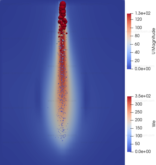

New Weber number cloud function object
The new WeberNumber cloud function object computes and writes the particle Weber number to disk at simulation write times. The field is written as a ’standard’ cloud field in <time>/lagrangian/<cloudName>/We available for further post-processing, e.g. using ParaView.
The cloud function object is specified in the constant/<cloudName>Properties<i> file as:
WeberNumber1
type WeberNumber;
The following example is taken from the aachenBomb tutorial case where the particles are coloured according to the Weber number and the carrier by the veocity magnitude.
![[Picture]](img/cloud-weberno.png)

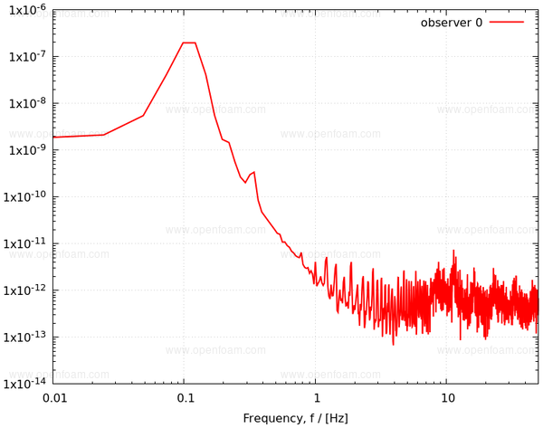

Both point and surface ouputs are supported by the noise utility, and can be used to e.g. highlight the vortex shedding frequency, here shown to be approximately 0.1 Hz.
![[Picture]](img/curle-plot.png)

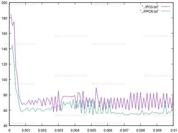

Purely looking at the coarsest level solution (overall number of sweeps needed to solve the coarsest level):
![[Picture]](img/PCG_vs_PPCR.png)
Coarse level number of sweeps
The PPCR solver requires less number of sweeps even though occasionally it requires more top-level GAMG cycles so more invocations of the coarse level solver. Overall statistics:
| Solver | Coarse level sweeps | Run time (s) |
| (P)PCG | 7539 | 405 |
| PPCR | 6324 | 401 |
Notes:
- simulation has only been run once so the timings are not representative
- simulation was run on 8 cores of the same node - no interconnect used
- no simulation statistics were compared - however no changes were made to the case setup apart from the solver choice.
Currently these settings are being tested on more representative cases (32, 64 milllion cells, >1000 cores). Timings so far show an improvement in scalability; we will report our findings later on separately from these release notes.

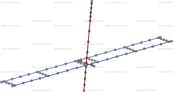

is defined in by its ”rigging”, which are motion controllers defined in terms of lumped points and connectivity. They can be considered the ”skeleton” for the movement.
![[Picture]](img/bridge-rigging.png)
Bridge rigging
