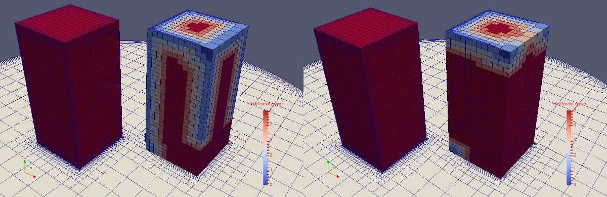

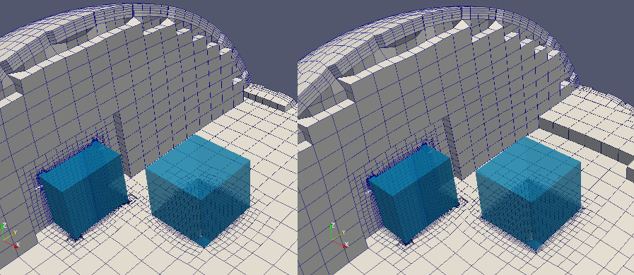

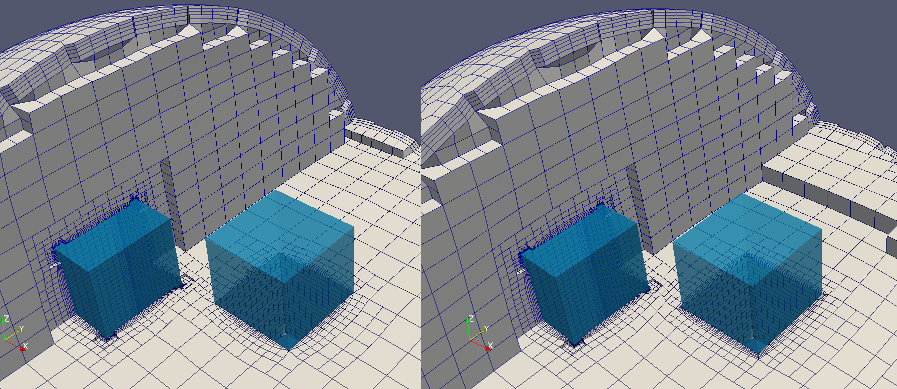

Following pictures show comparison of two shrinking algorithms applied to iglooWithFridges tutorial. Left picture shows the default algorithm, while the right picture shows the displacement motion solver. Each picture shows two boxes. The left one with specified features refinement and the right box without the feature refinement. The default algorithm is not very successful in adding layers at the corners when the mesh is coarser (right box) while the displacementMotionSolver is capable to add layers even on coarser mesh. The contour in the bottom picture shows the number of layers added. The red colour represents all five layers requested, while dark blue stands for zero layers.
