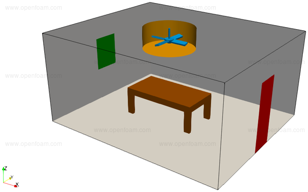

The geometry for this tutorial consists of

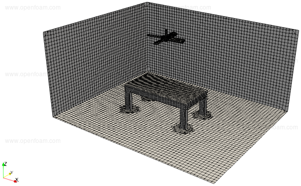

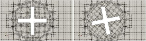

After these steps you can visualize your mesh in ParaView:
Here you can see the rotating and non-rotating regions of the mesh:

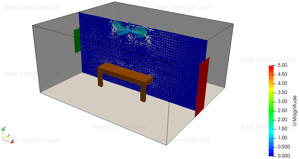

Here you see the flow after t = 0.64 s.

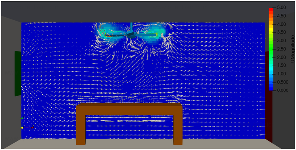

Velocity magnitude and vectors on a y-normal plane:
Close-up of velocity magnitude and vectors on a y-normal plane:
