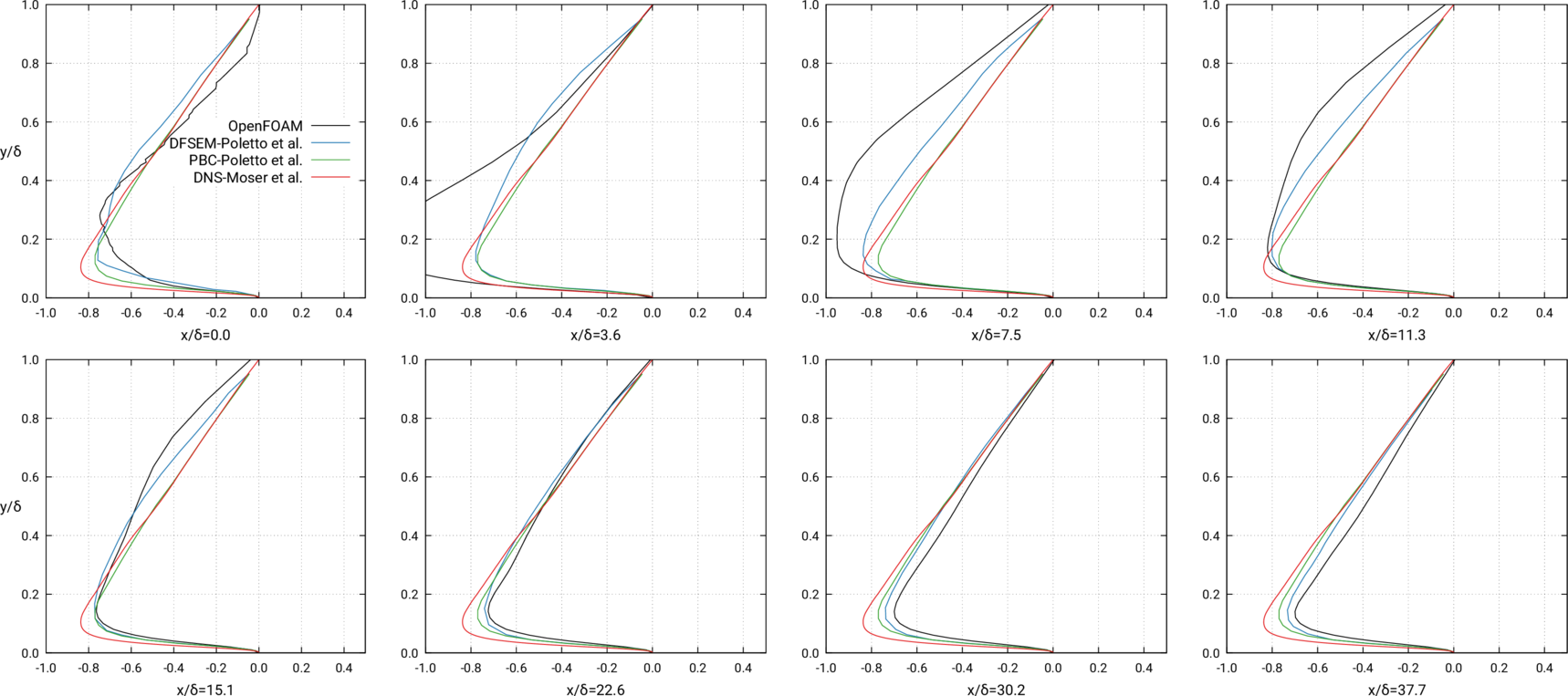

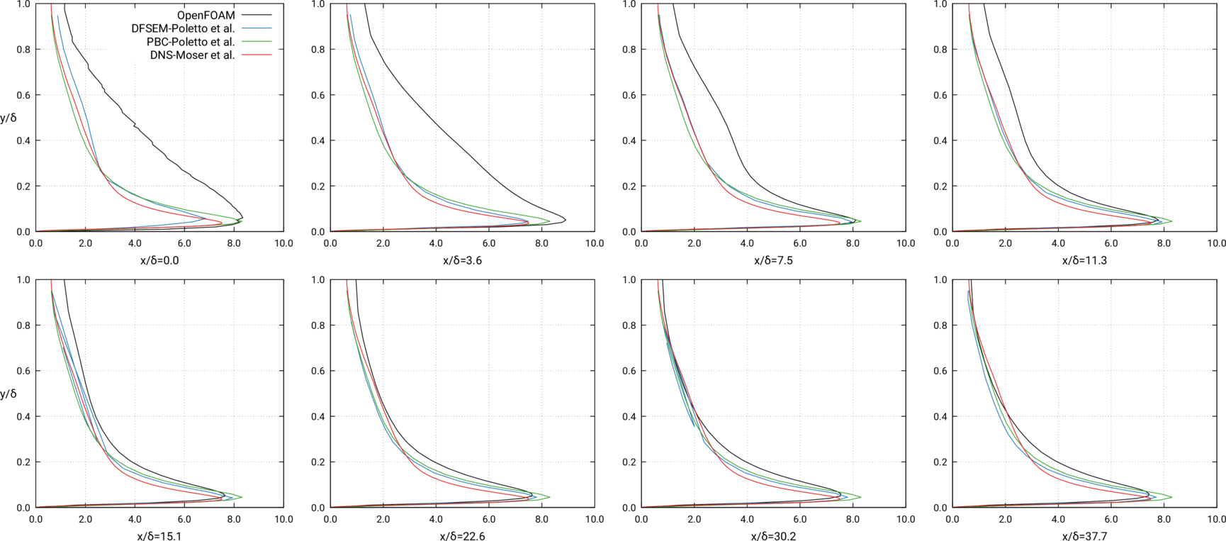

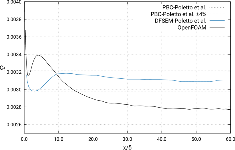

- Prescribed vs. reproduced Reynolds stress tensor components at inlet patch

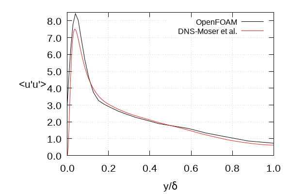

- \( \overline{u^\prime u^\prime} \) downstream development vs. \( x/ \delta \)

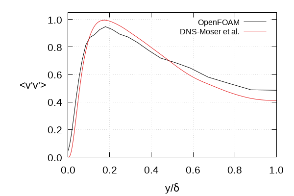

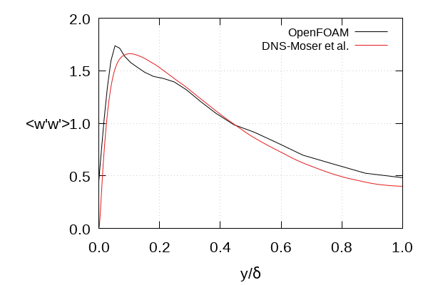

- \( \overline{v^\prime v^\prime} \) downstream development vs. \( x/ \delta \)

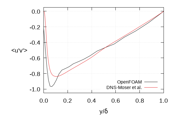

- \( \overline{u^\prime v^\prime} \) downstream development vs. \( x/ \delta \)
- Surface skin friction coefficient \(\mathrm{C}_f\) vs. \(x/ \delta \)

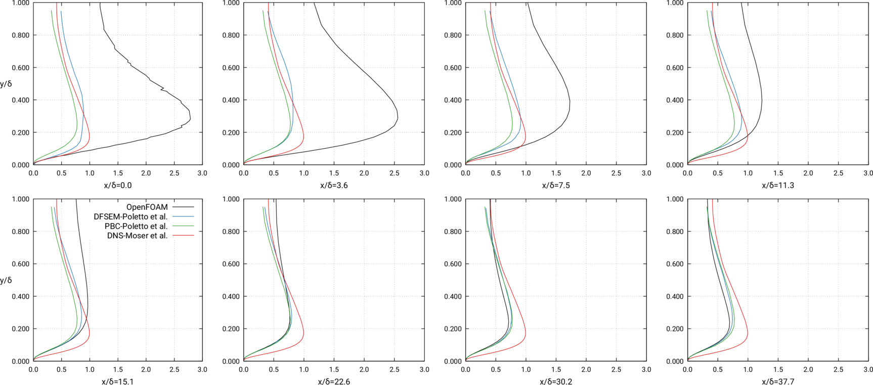

- Streamwise mean flow speed and Reynolds stress tensor components at uniform-interval downstream profiles

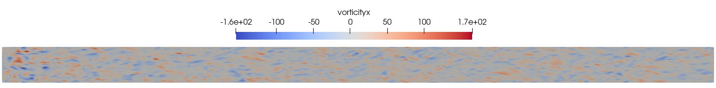

- Streamwise vorticity \( \omega_x \) at \(x/ \delta = 0.1\)

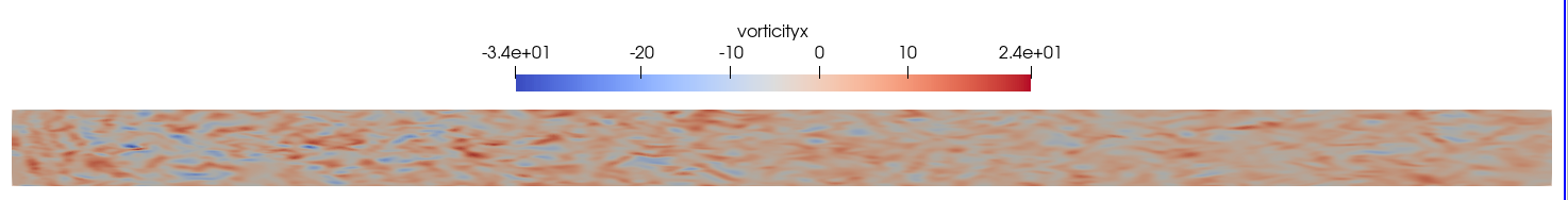

- Streamwise vorticity \( \omega_x \) at \(x/ \delta = 1.0\)
- Metrics are time and spanwise averaged
- \( \{ < \cdot > \} \) is the time-averaging operator
Prescribed vs. reproduced Reynolds stress tensor at inlet patch (Poletto et al., Fig. 4)
<u'u'>-component of Reynolds stress tensor - Downstream development (Poletto et al., Fig. 14)
<v'v'>-component of Reynolds stress tensor - Downstream development (Poletto et al., Fig. 15)
<u'v'>-component of Reynolds stress tensor - Downstream development (Poletto et al., Fig. 13)
Longitudinal skin friction coefficient at top patch - Downstream development (Poletto et al., Fig. 9)
Longitudinal skin friction coefficient at bottom patch - Downstream development (Poletto et al., Fig. 9)
Streamwise vorticity component at y/δ=0.05 (Poletto et al., Fig. 11)
Streamwise vorticity component at y/δ=1.0 (Poletto et al., Fig. 12)
