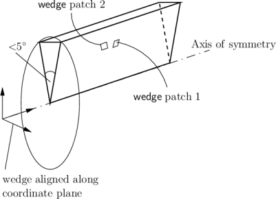

- wedge
- For 2 dimensional axi-symmetric cases, e.g. a cylinder, the geometry
is specified as a wedge of small angle (e.g.
) and 1 cell thick
running along the plane of symmetry, straddling one of the coordinate
planes, as shown in Figure 4.3. The axi-symmetric wedge planes
must be specified as separate patches of wedge type. The details of
generating wedge-shaped geometries using blockMesh are described in
section 4.3.3.
