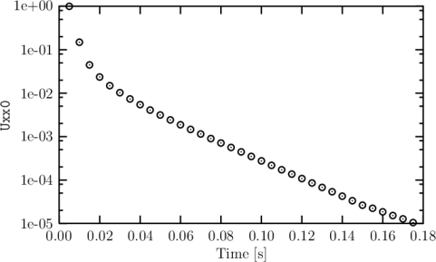

For example, in the cavity tutorial we may wish to observe the initial residual
of the Ux equation to see whether the solution is converging to a steady-state. In
that case, we would plot the data from the logs/Ux_0 file as shown in Figure 6.1.
It can be seen here that the residual falls monotonically until it reaches the
convergence tolerance of
