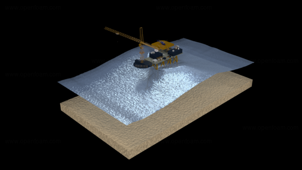

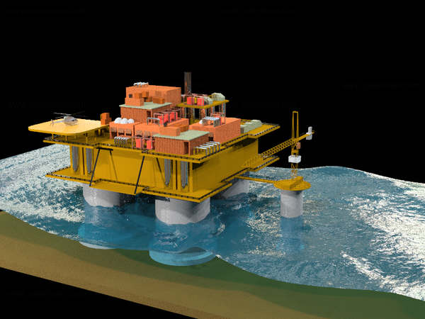

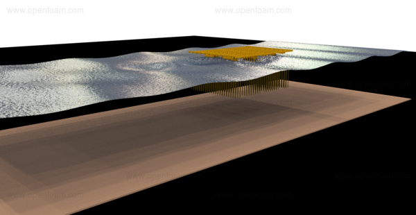

The following images show some applications using the new code, supplied by IHCantabria
![[Picture]](img/wave-models-mussels-rafts-small.png)
Mussel Raft
![[Picture]](img/wave-models-offshore-platform-small.png)
Fixed Offshore Platform
![[Picture]](img/wave-models-offshore-platform-2-small.png)
Jacket Offshore Platform
