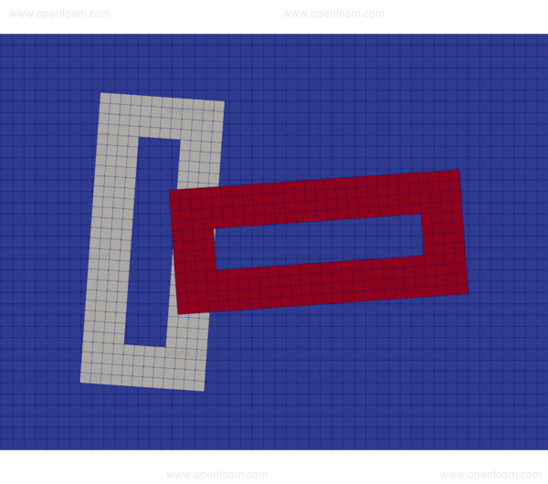

OpenFOAM v1706 includes the first release of a major new set of functionality to enable users to perform overset mesh calculations. The approach performs cell-to-cell mapping between multiple, disconnected mesh regions, to generate a composite domain applicable to both static and dynamic analyses.
The mapping is used to determine which parts of the mesh are:
- solved, calculated;
- interpolated from solution cells, interpolated; and
- not used, holes
The result is a straightforward method to perform complex mesh interactions without the need to employ, e.g. challenging topological changes. An example showing the background mesh (blue) with two sub-meshes that represent rotors is shown below:

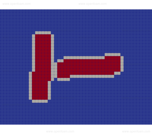

Here, the overset analysis takes this 3-part mesh and determines the cell types. For the background mesh, the result is given by:
![[Picture]](img/twoSimpleRotors_cellTypes-small.png)
Results from cell type analysis
where the colours correspond to:
- blue: calculated
- white: interpolated
- red: blocked
