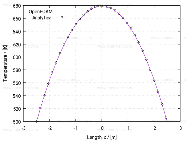

The following image shows the result of a validation study that compares the OpenFOAM prediction from the chtMultiRegionSimpleFoam case referenced below vs an analytical solution
OpenFOAM vs analytical solution

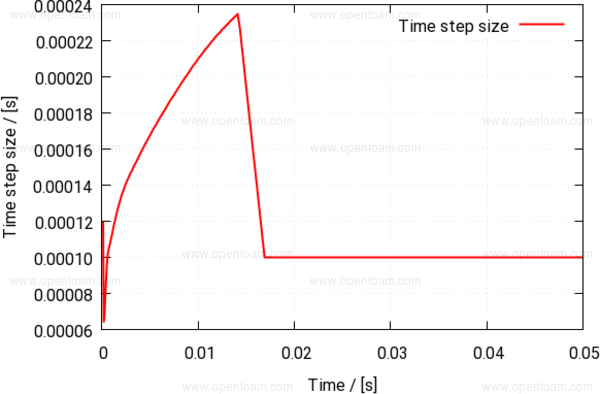

Updated time step controls
The setTimeStep function object has been updated to enable a smooth variation of the time step size.
In the following example, the time step begins to vary after 0.014s as defined by the timeStart entry. The change in step size is limited by the deltaTCoeff entry, which represents the maximum change allowed compared to the current value, in order to reach the target step size of 1e-4s.
type setTimeStep;
libs ("libutilityFunctionObjects.so");
// Start changing the time step after 0.014s
timeStart 0.014;
// Target time step size
deltaT 1e-4;
// Max ratio between steps, GREAT if not defined (default)
// Note: must be greater 1
deltaTCoeff 1.05;
writeControl adjustableRunTime;
writeInterval 0.05;
An example of the time step size history is given below.
Time step size variation
