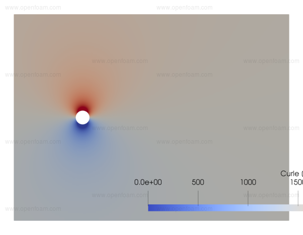

Curle acoustic analogy
The new Curle function object computes the acoustic pressure based on Curle’s acoustic analogy.
The output is a new volume field, Curle, which is stored on the mesh database for further post-processing, e.g. for surface plots and point sampling. An example of the required input is shown below:
libs ("libfieldFunctionObjects.so");
type Curle;
patches (cylinder);
c0 343;
![[Picture]](img/post-processing-curle-small.png)
Predicted Curle acoustic pressure for a cylinder source

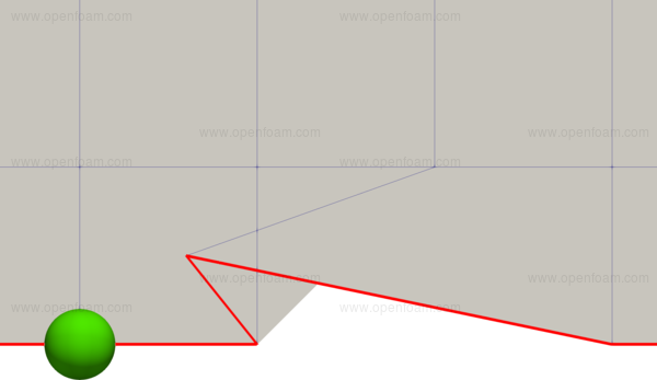

Updated particle tracking for wall-bounded streamlines
The wall-bounded streamline algorithm has been rewritten to enable tracking along (faces of) inverted cells. These cells are readily created by many meshing tools, e.g.snappyHexMesh, when attempting to conform to complex surfaces. The following image shows a square mesh where a single cell has been inverted:
![[Picture]](img/post-processing-wall-bounded-streamlines-small.png)
Tracking (red line) along inverted cells
Starting from the left, the red pathline demonstrates tracking through the inverted boundary face. In combination with the zeroGradient function object to obtain the tracking velocity, this provides a more robust solution for obtaining streaklines.
