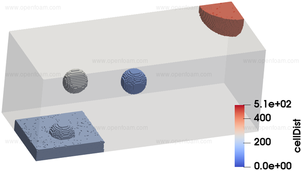

New geometric constraints for decomposePar
The new geometric decomposition constraints may be used to prevent the decomposition of regions of the mesh. This can be useful when a particular part of the simulation domain should remain on the same processor.
The constraint is used to define which faces shall remain connected on the same processor. The geometric elements are defined with a syntax familiar from snappyHexMesh.
type geometric;
geometry
box1
type box;
min (-10 -10 -10);
max (1 1 1);
ball1
type sphere;
origin (-2 -2 1);
radius 1;
![[Picture]](img/parallel-geometric-constraints.png)
Illustrates the cell distribution as influenced by various geometric constraint.
