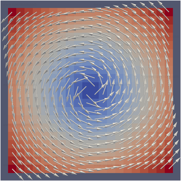

Example of a swirl velocity boundary condition:
coordinateSystem
type cylindrical;
e1 (0 1 0);
e3 (1 0 0); // axis direction
origin (0 0 0);
// Time-dependent uniform value (in local coordinates)
// Velocity is 1 in axial and -1 in tangential direction
uniformValue (0 -1 1);
// Local-coordinate dependent scaling:
// scale1 : per-component scaling according to coordinate 1(= 'r'):
// - at r=0 only axial component is preserved (scale 1)
// - at r=1 radial and tangential components multiplied by 2
scale1 table ((0 (0 0 1))(1 (2 2 1)));
![[Picture]](img/bcs-swirlTop.png)
Example of a time-ramping annular profile (with linear variation across the radius) (unscaled arrows, coloured with velocity magnitude)
