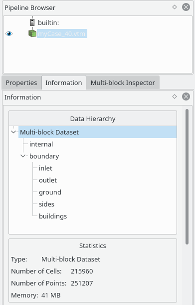

![[Picture]](img/post-pro-vtk-vtmblock.png)
myCase_40/
|-- boundary
| |-- buildings.vtp
| |-- ground.vtp
| |-- inlet.vtp
| |-- outlet.vtp
| - sides.vtp
|-- boundary.vtm
- internal.vtu
The .vtm file provides a very lightweight container to organize VTK content and preserves the original numerical ordering of the patches. For convenience, a boundary.vtm file is also generated with the boundary/ directory, which can be convenient when only values on the surface are required.

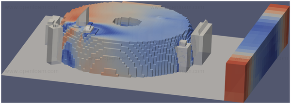

Region of interest output
In some cases only a particular region of the simulation is of interest for more in-depth visualisation. The vtkWrite and ensightWrite function objects have been extended to support a flexible region-of-interest selection mechanism. If the selection sub-dictionary is not specified, then the entire mesh will be converted. With a selection sub-dictionary, the initial selection is empty and the user can define their preferred output region. The syntax is based on that of topoSet. For example,
type vtkWrite;
selection
box
action use;
source box;
box (-0.1 -0.01 -0.1) (0.1 0.30 0.1);
dome
action add;
source sphere;
origin (-0.1 -0.01 -0.1);
radius 0.25;
centre
action subtract;
source sphere;
radius 0.1;
![[Picture]](img/post-pro-vtk-vtkSubset.png)

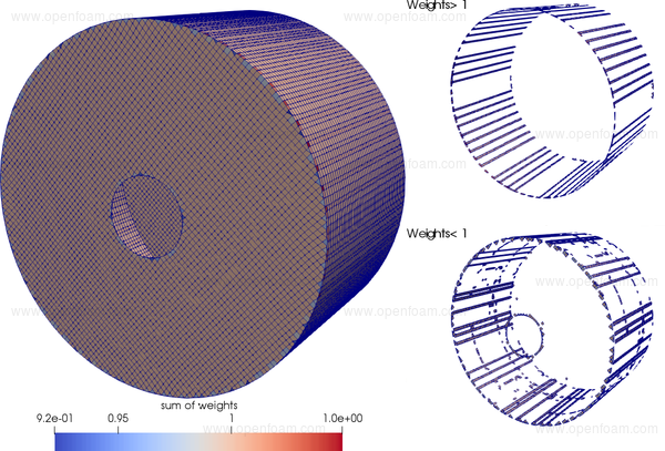

New function object to compute AMI patch performance
Cases that employ cyclic AMI patches are sensitive to the quality of the AMI interpolation weights. Closer inspection of the weights is now provided by the new AMIWeights function object that writes weight statistics to file during the run and VTK-based surfaces. Statistic per AMI include:
- patch names
- whether the patch is parallel-distributed
- minimum and maximum sum of weights (should be 1 for a perfect match)
- minumum and maximum interpolation stencil size
Sample output for the $FOAM_TUTORIALS/incompressible/pimpleFoam/RAS/propeller case:
# Time Patch nbr_patch distributed src_min_weight src_max_weight src_average_weight src_min_neighbours src_max_neighbours ...
0.001 AMI1 AMI2 true 9.264461e-01 1.047157e+00 1.000202e+00 1 9 ...
0.002 AMI1 AMI2 true 9.392015e-01 1.019850e+00 1.000039e+00 1 8 ...
0.003 AMI1 AMI2 true 9.239401e-01 1.049830e+00 1.000198e+00 1 9 ...
0.004 AMI1 AMI2 true 9.490245e-01 1.022364e+00 1.000048e+00 1 9 ...
0.005 AMI1 AMI2 true 9.216583e-01 1.047407e+00 1.000176e+00 1 9 ...
0.006 AMI1 AMI2 true 9.230133e-01 1.021246e+00 1.000040e+00 1 9 ...
0.007 AMI1 AMI2 true 9.201124e-01 1.050923e+00 1.000175e+00 1 9 ...
If the writeFields entry is set to true VTK files are written that can be used to identify where the sum of the weights is not 1, e.g.:
![[Picture]](img/post-pro-ami-weights.png)

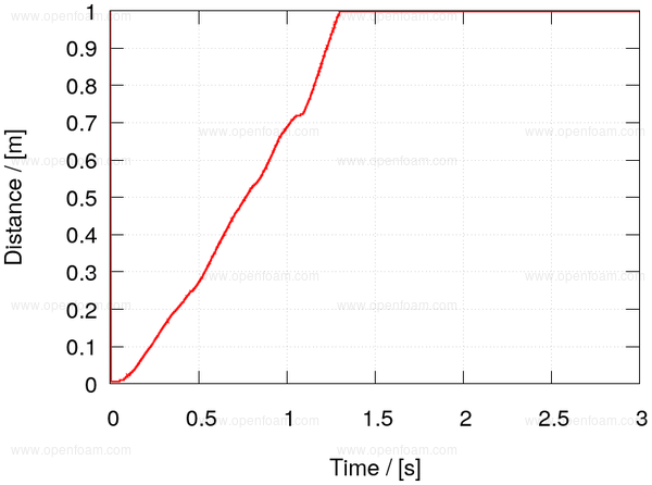

New function object to compute field extents
Quantifying how far a field has spread has been made straightforward using the new fieldExtents function object. It works out the distance between a reference point and the location at which the field exceeds a threshold value. An example for the rivuletPanel test case shows the rate at which the film traverses the panel:
![[Picture]](img/post-pro-field-extents.png)
- Source code
- $FOAM_SRC/functionObjects/field/fieldExtents
- Examples
- $FOAM_TUTORIALS/lagrangian/reactingParcelFoam/rivuletPanel

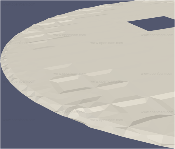

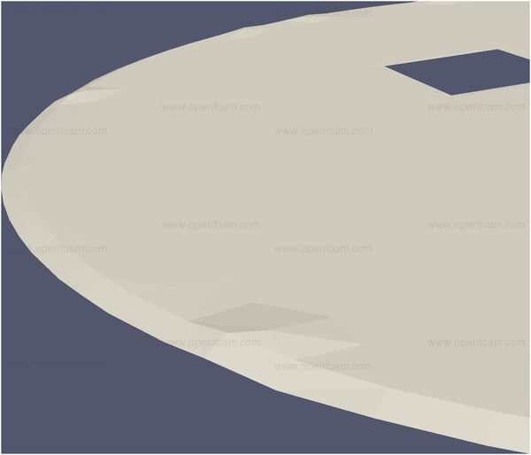

![[Picture]](img/post-pro-isoSurfaceCell.png)
The isoSurfaceCell algorithm on a snappyHexMesh
![[Picture]](img/post-pro-isoSurfaceTopo.png)
The isoSurfaceTopo algorithm on a snappyHexMesh
The filtering can occasionally generate non-manifold surfaces, and can be deactivated by setting regularise false.
Following further evaluation, this iso-surface method might replace the isoSurfaceCell option in future releases.
