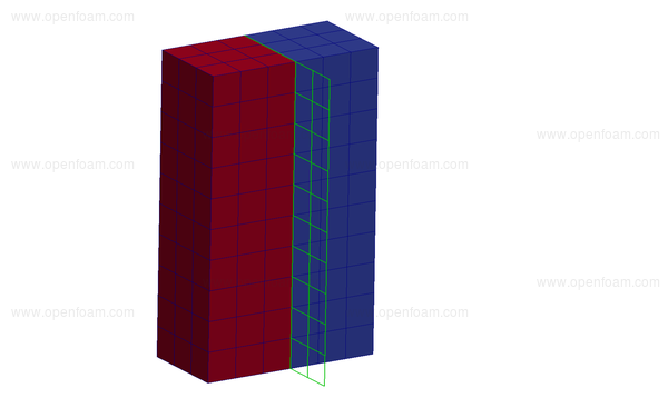

![[Picture]](img/meshing-snappy-locations-in-mesh-small.png)
Two abutting cellZones (red and blue) are defined by singly providing two locations in mesh. This automatically constructs faceZones for the outside of the cellZones e.g. shown in green is the faceZone defined between the two cellZones.

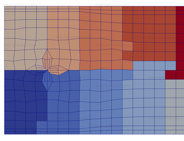

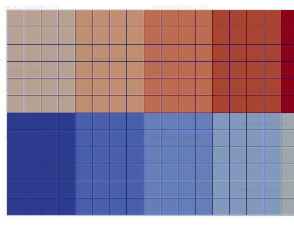

In version v3.0+ snappyHexMesh added support for layers on faceZones. In this version this has been extended to allow layers on complex configurations, e.g. crossing faceZones. The following image for a straight block mesh is coloured by processor index.
![[Picture]](img/meshing-snappy-layers1-small.png)
Here, layers are added to top and bottom and to two faceZones that both cross processor boundaries and each other.
![[Picture]](img/meshing-snappy-layers2-small.png)
Note that snappyHexMesh has automatically re-distributed the resulting mesh to keep a good load balance.
