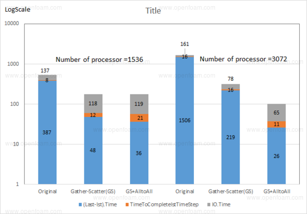

Following a review by the Japanese Research Organisation for Information Science and Technology (RIST) a collection of enhancements were suggested, based on tests using the pimpleDyMFoam solver. The resulting recommendations lead to a significant performance benefit when employing a large number of processors. The optimisations comprised:
- all-to-all processor size information exchange (performance)
- changing the gather/scatter order (performance)
- on-the-fly calculation of the communication schedule (memory)

In this version we only obtain the sizes for the current processor. This improves the performance of any variable-sized parallel transfer e.g. geometry initialisation, geometry overlap calculation, Lagrangian particle transfer. This leads to a substantial improvement for moving mesh solvers. For non-Lagrangian, static mesh solvers the effect is a slightly reduced startup time.
Changing the gather/scatter order
Parallel gather/scatter routines are used to synchronise data across processors. Those used most often e.g. in the linear solvers, are already heavily optimised but all others are coded as a gather followed by a scatter operation. These routines use ‘blocking’ communication so as not to allocate any buffers (since the amount to send is generally trivial) and a tree-like communication schedule where each processor receives from ‘below’ processors and sends to the ‘above’ processor (and vice-versa for scatter) The tree is asymmetric such that in ‘gather’ the order of receive is such that the ‘below’ processor with the lowest sub-tree depth is received from first, thus minimising the critical path. In this version a similar optimisation has been done for the ‘scatter’/sending algorithm. Unlike the previous optimisation, this affects all solvers.

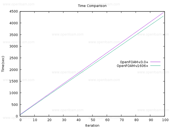

The net effect of these optimisations on a medium sized cluster with a fast network, e.g. 128 processors, 6 cores per node, DDR Infiniband network, shows an improvement of approximately 5% when using the rhoPimpleDyMFoam solver,
![[Picture]](img/parallel-performance-improvements-rhopimpledymfoam-small.png)
and similar values for the rhoPimpleFoam solver. The amount of speedup expected scales roughly with the square of the number of processors, suggesting significant benefits at higher processor counts.
