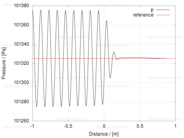

Acoustic damping
The new acousticDampingSource fvOption has been implemented to damp spurious pressure waves for acoustic analyses. The new acoustic damping, sometimes referred to as an acoustic sponge-zone, combines the theories of acoustic resistivity, porous resistance and inertial under-relaxation based on a reference solution taken from the far-field steady or mean flow. The new model is designed to:
- damp acoustic waves generated from unsteady flow before they propagate to imperfect non-reflective inflow/outflow boundaries, and
- damp the generation and propagation of spurious numerical acoustic waves in low-quality meshes and severe mesh coarsening/refinement interfaces.
The user supplies both a damping coefficient, targeting a frequency or frequency range, and a ramping distance based on characteristic wavelengths, e.g.
type acousticDampingSource;
active yes;
acousticDampingSourceCoeffs
timeStart 0.00;
duration 1000.0;
selectionMode cellZone;
cellZone selectedCells;
centre (0 0 0);
radius1 0.1;
radius2 1.2;
frequency 3000;
URef UMean;
, is
damped using a cosine-ramping function within
to
wavelengths,
![[Picture]](img/noise-acoustic-damping-1d-small.png)
- Examples
- Sine wave damping 1-D: $FOAM_TUTORIALS/compressible/rhoPimpleFoam/laminar/sineWaveDamping
A 3-D example of acoustic damping of a shedding cylinder is also available in OpenCFDs Exchange Platform Knowledge Base.
