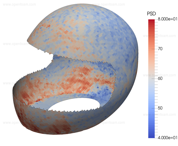

The following series of images show results from an assessment of the rider’s helmet from the motorBike tutorial. The PSD at 793 Hz is shown below.
![[Picture]](img/noise-fft-helmet-psd-793hz-small.png)

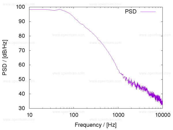

Surface average PSD as a function of frequency:

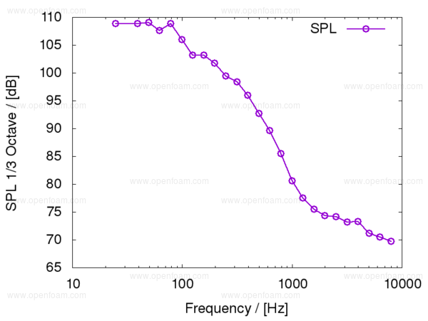

Surface average 1/3 octave SPL as a function of frequency:

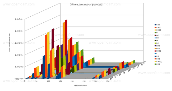

Reaction sensitivity
The new reactionSensitivityAnalysis function object indicates the reaction rates of creation or destruction of species in each reaction for chemistry solvers.
It is specified using in the controlDict using:
sensitivityAnalysis
functionObjectLibs ("libutilityFunctionObjects.so");
type psiReactionsSensitivityAnalysis;
outputControl outputTime;
enabled true;
- consumption.dat: consumption rate
- production.dat: destruction rate
- productionInt.dat: integral between dumps of the production rate
- consumptionInt.dat: integral between dumps of the consumption rate
The output format e.g. for the consumption.dat file takes the form:
delta T: 1e-5
Reaction specie1 specie2
1 RR11 RR12
2 RR21 RR22
time : 2e-2
delta T: 1e-5
1 RR11 RR12
2 RR21 RR22

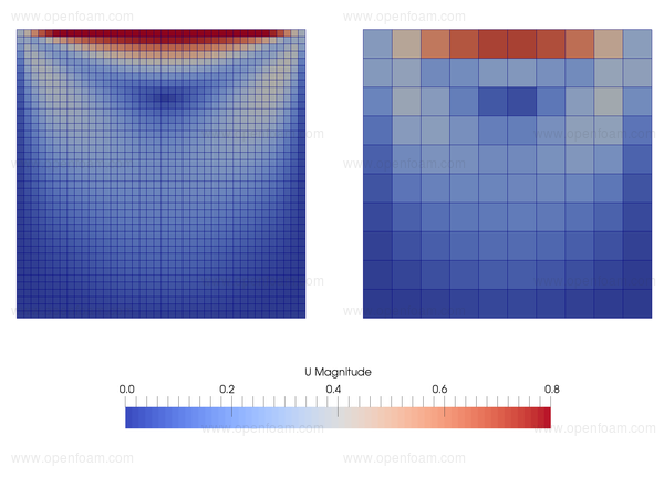

Field mapping function object
The new mapFields function object enables field values to be mapped to a secondary mesh at run time. If performing, e.g. flow cases where the aim is to map field data onto a coarser mesh, this object can save a lot of disk space.
The function object is specified in the controlDict using:
type mapFieldsFO;
outputControl timeStep;
outputInterval 1;
mapRegion coarseMesh;
mapMethod cellVolumeWeight;
consistent yes;
fields (U); // ("U.*" "p.*");
