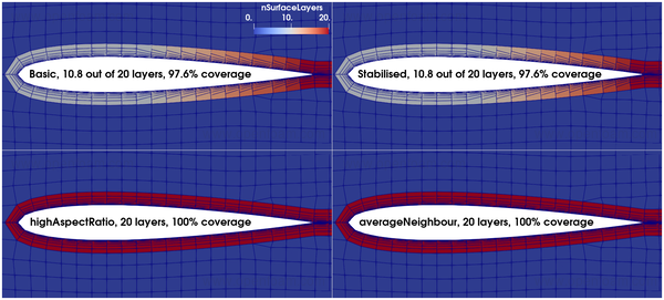

- highAspectRatio
- This scheme blends between basic and an edge-length weighted, face-area weighted average. This avoids truncation errors on high aspect ratio cells, at the cost of being lower order. The blending is linear across the range minAspect, maxAspect (see example above).
- averageNeighbour
- Similar to highAspectRatio but followed by a pass to align cell centres on top of one another to minimise non-orthogonality.
Specifying the method to calculate the geometric properties instead of e.g. limiting the effect on discretisation means that it also affects the mesh generation. This is especially important for mesh generators that use the mesh quality e.g.snappyHexMesh.
These options can be used to great effct to produce many more layers than the default method, e.g. for a wing profile:

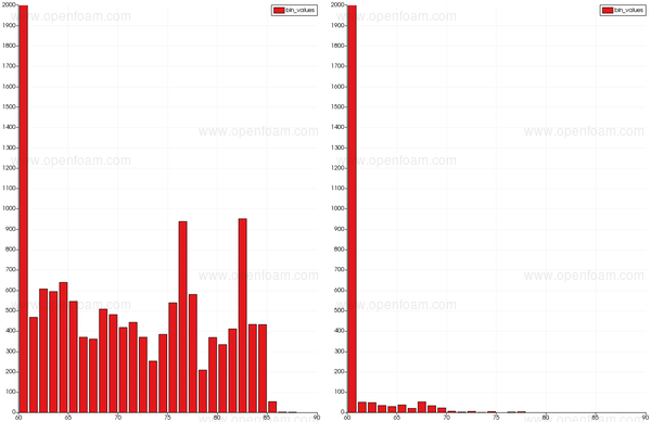

The averageNeighbour scheme can be very effective for tetrahedral and high-aspect ratio prismatic boundary layer meshes. These might have a very high non-orthogonality angle in the prism boundary layer due to truncation errors and alignment.
The figure below shows a comparison of the distribution of the non-orthogonality angle when computed with the basic scheme (left) and averageNeighbour (right).

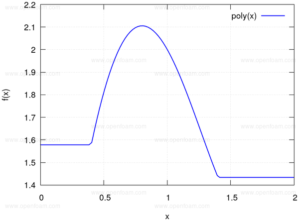

The new limitRange class provides a wrapper for Function1s that enables users to set minimum and maximum limits on input values. For example, applying limits to a polynomial entry:
limitedPolyTestCoeffs
min 0.4;
max 1.4;
value polynomial
(5 1)
(-2 2)
(-2 3)
(1 4)
Here, the return value will be:
- poly(0.4) for
- poly(1.4) for
; and
- poly(x) for
