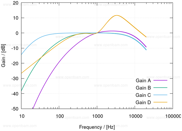

New noise utility weightings
Noise-related models have been refactored, and A, B, C, and D weightings made available.
The weighting can be selected using the new SPLweighting keyword, where options include:
- none: no weighting (default)
- dBA: dB(A) weighting
- dBB: dB(B) weighting
- dBC: dB(C) weighting
- dBD: dB(D) weighting

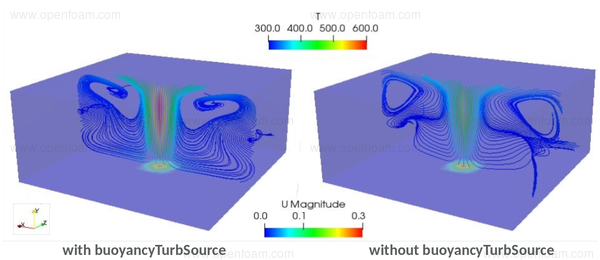

New buoyancy fvOption
The buoyancyTurbSource finite-volume option applies sources on turbulent kinetic energy, k, and either turbulent kinetic energy dissipation rate, epsilon, or specific dissipation rate, omega, to incorporate effects of buoyancy on turbulence in incompressible and compressible flows. It is generally applicable where density gradients exist such as compressible heat transfer and wave modelling using the volume-of-fluid method. The minimum working example of this finite-volume option can be seen below:
type buoyancyTurbSource;
beta 3.3e-03;
rho rho;
alphat alphat;
T T;
$FOAM_TUTORIALS/heatTransfer/buoyantBoussinesqSimpleFoam/hotRoom
![[Picture]](img/solver-and-physics-buoyancyturbsource-fvoption.png)
- Source code
- $FOAM_SRC/fvOptions/sources/derived/buoyancyTurbSource
- Tutorial
- $FOAM_TUTORIALS/heatTransfer/buoyantBoussinesqSimpleFoam/hotRoom
