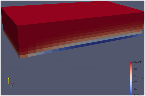

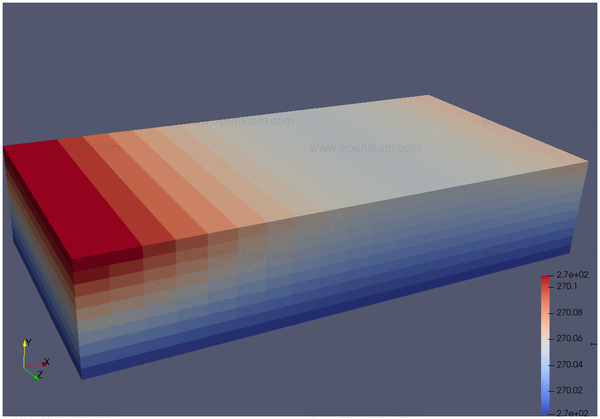

New multi-application coupling through boundary conditions
In this release the explicitly coupled patch and boundary conditions, e.g.mapped, mappedField, turbulentTemperatureCoupledBaffleMixed etc. have been extended to communicate between different applications. Each application now has an optional world command line argument, later referred to in the mapped condition by the sampleWorld entry. Internally the coupling is performed through an MPI communicator so there is no file system overhead. There are currently two ways of interfacing:
Boundary condition to boundary condition
This coupling is triggered every time the value of the boundary condition is updated. This limits the running to solvers where both sides run exactly the same number of evaluations.
For example, two worlds, one fluid and one solid, each running on one processor are started using an mpirun (OpenMPI syntax) command:
-np 1 solidFoam -world solid
sampleMode nearestPatchFace;
sampleWorld solid;
sampleRegion bottomSolid;
samplePatch top;
![[Picture]](img/parallel-multi-world-coupling01.png)
![[Picture]](img/parallel-multi-world-coupling02.png)
