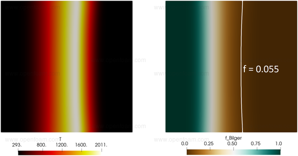

New function object: BilgerMixtureFraction
The new BilgerMixtureFraction function object calculates the Bilger mixture-fraction field based on the elemental composition of the mixture. Elements C, H, S and O are considered.
The Bilger mixture-fraction field is the mass mixing ratio of fuel and oxidiser in [kg fuel / kg mixture], and is reportedly invariant to the reaction progress of the mixture, e.g. the same for unburnt and burnt mixtures. The fraction is unity for pure fuel and zero for pure oxidiser.
A minimal working example of this function object can be seen below:
type BilgerMixtureFraction;
libs (fieldFunctionObjects);
fuel
fractionBasis mass;
CH4 1;
oxidiser
fractionBasis mole;
O2 0.23;
N2 0.77;
phase <phaseName>;
result <resultName>;
A set of images of Bilger mixture-fraction field, f_Bilger, is presented below
that shows the validation of the method and verification of the implementation
from the tutorial
$FOAM_TUTORIALS/combustion/reactingFoam/laminar/counterFlowFlame2D

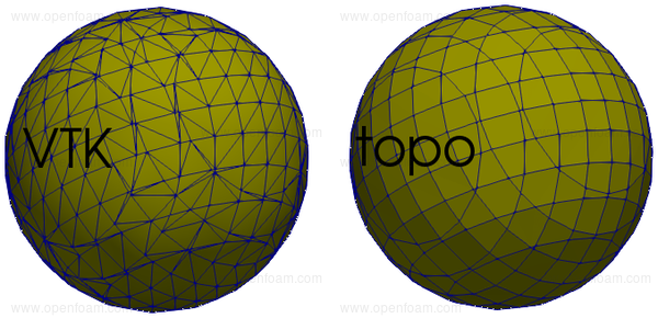

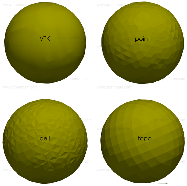

sampledSurfaces : IsoSurface
The iso-surface sampling has been revised and rationalised. There are three different methods for generating iso-surfaces and sampling, which are now selectable via the isoMethod. The default method has changed from point to topo. The three methods in summary:
- point : previous default, this is the oldest. The generated triangles span cell divisions, and generally needs interpolation for correct results.
- cell : uses a cell-based snapping method during generation. Mostly gives better results than the point method.
- topo : this is the new default and the newest method. Uses topological cell cutting for more accuracy and consistency. In some cases it may miss some surface features.
For example,
type isoSurface;
isoMethod topo; // (point | cell | topo)
![[Picture]](img/post-processing-sampling-isosurface01.png)
The newest iso-surface method in OpenFOAM, the topo method, generates the lowest number of faces.
![[Picture]](img/post-processing-sampling-isosurface02.png)

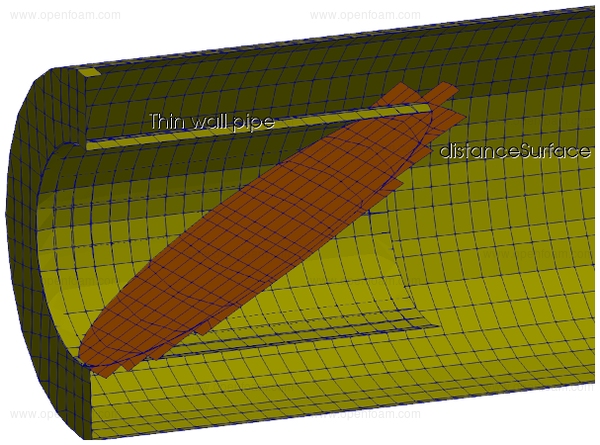

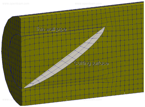

sampledSurfaces : distanceSurface
In addition to the original purpose of distanceSurface to create a sampled surface at a distance from an input surface, it can now be used to sample at a zero distance from an input surface. In this mode it works much like a cell cutting method for generating surfaces, as illustrated in the following image:
![[Picture]](img/post-processing-distance-surface01.png)
The main challenge with the zero distance mode arises from the edges of the surface and intersection tolerances. If an edge of the surface ends within a cell, cell cutting is performed for the entire cell. This is usually sufficient, but under certain conditions would leak information and cause undesirable effects:
![[Picture]](img/post-processing-distance-surface02.png)
The distance information results in undesirable fringe faces being generated on the outside of the thin walled pipe. From the algorithm’s point of view, this is perfectly reasonable since the cells in question are within very close proximity of the original surface (indeed we cannot be certain that the original surface did not actually penetrate slightly through the wall). However, the result is certainly not what we want.

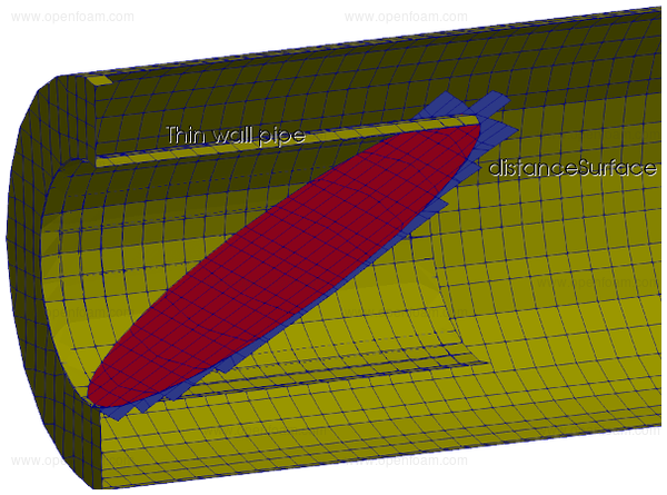

The user can now specify an additional topology filter within distanceSurface to define how to retain/discard parts of the surface. A proximity check is often the simplest choice for most cases; other filters options include:
- proximity (post-filter)
- Checks the resulting faces against the original search surface and rejects faces with a distance greater than absProximity.
- largestRegion (pre-filter)
- Cut cells are checked for topological connectivity and the region with the most number of cut cells is retained. This handles the ”ragged” edge problem.
- nearestPoints (pre-filter)
- Cut cells split into regions, the regions closest to the user-defined points are retained. Uses maxDistance entry for additional control.
The intermediate results of the proximity filter are as shown in the following:
![[Picture]](img/post-processing-distance-surface03.png)
After filtering, the resulting surface is now as expected. It is important to note that the distance surface works on a volume cell level (it uses an iso-surface algorithm) and thus the resulting surface is independent of the resolution of the original surface.
![[Picture]](img/post-processing-distance-surface04.png)

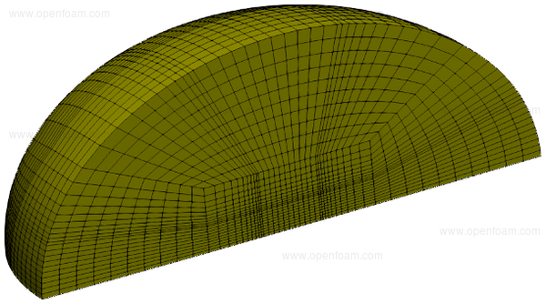

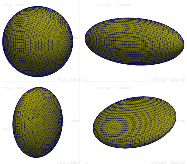

$FOAM_TUTORIALS/mesh/blockMesh/spheroid7Projected
$FOAM_TUTORIALS/mesh/blockMesh/spheroidProjected - Attribution
- A contribution from Victor Olesen

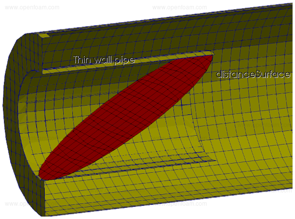

Updated searchableDisk
The searchableDisk surface now has an optional innerRadius value to represent annular geometries, e.g.
type disk;
origin (0.45 0 0);
normal (1 0 0);
radius 0.09;
innerRadius 0.05;
- Source code
- $FOAM_SRC/meshTools/searchableSurfaces/searchableDisk
- Tutorial
- $FOAM_TUTORIALS/compressible/rhoSimpleFoam/gasMixing/injectorPipe
