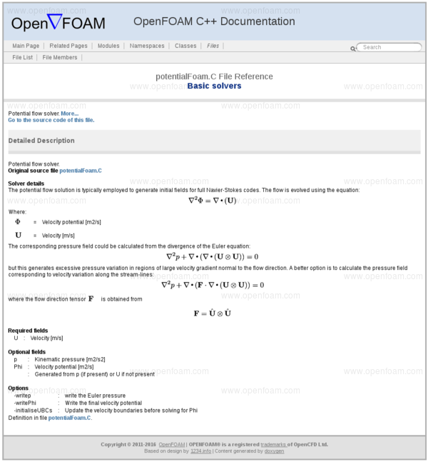

) - If specific help is required, e.g.: for the potentialFoam solver, the Doxygen
help can be invoked by issuing the command this will open the help for the potentialFoam solver in a browser window as shown belowfoamHelp solver -browse potentialFoam

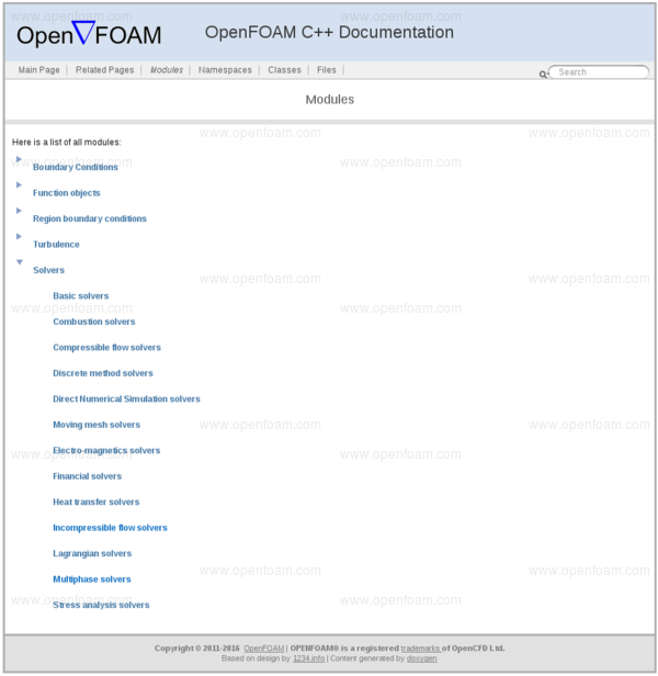

From the Modules tab on the guide information can now be accessed for:
- Boundary conditions
- Function objects
- Region boundary conditions
- Turbulence
- Solvers
The new Solvers section provides a top-level list of all available solvers:

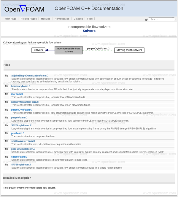

Following, e.g. the Incompressible flow solvers link leads to a summary of all incompressible solvers:
Following, e.g. the icoFoam.C link leads to the documentation for the icoFoam solver.
