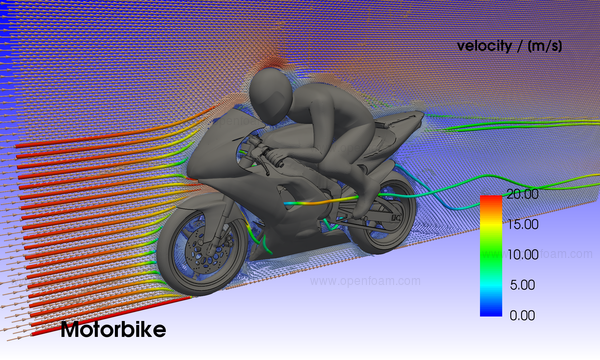

The picture below shows an example image generated at run-time for a motorbike case, including surface geometry with feature lines, streamlines, vector glyphs and annotations.
![[Picture]](img/postprocessing-motorBike-small.png)
- Example
- $FOAM_TUTORIALS/incompressible/pisoFoam/les/motorBike

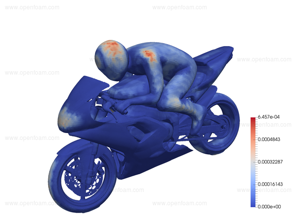

This will generate the additional (vector) fields in the time directories:
- <functionObjectName>:force
- <functionObjectName>:moment
- <functionObjectName>:forceCoeffs
- <functionObjectName>:momentCoeffs
The following image shows an example of the force coefficient output on the surface of the motorBike tutorial:
