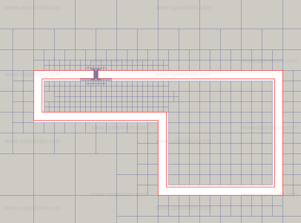

snappyHexMesh: close-proximity feature detection
An important feature of snappyHexMesh is to be able to specify regions of higher refinement in small gaps and between close features. Identifying these regions manually for highly complex surfaces with large length scale variations this might involve a lot of painstaking interaction.
This release adds the ability to detect and refine regions with close features automatically, e.g. for small pipes and gaps.
The detection algorithm works in two passes: it is a surface-only based algorithm when the mesh resolution is too low and switches to a mesh based one once there is enough mesh resolution. The surface-only algorithm works on a triangulated surface only (triSurfaceMesh) and detects triangle centres close to opposing surfaces. This detection pass enables starting snappyHexMesh from a single cell.
Usage is as follows:
planarAngle 30;
refinementRegions
ref1
mode inside;
levels ((10000 0)); // Dummy base-level refinement
// If cells
// - are inside geometry ref1
// - have level 0..9
// - and are in a gap < 4 cell sizes across
// refine them
gapLevel (4 0 10);
// Optional limiting of gap detection based on the
// local surface normal (of the nearest surface).
// The default is mixed, i.e.
// ignore the normal and detect gaps irrespective
// whether they are inside or outside of the geomtry.
// - options: inside, mixed, outside
gapMode inside;
The specification is enabled by using the gapLevel keyword in a refinementRegion (in the refinementRegions section in the snappyHexMeshDict dictionary) and consists of three integers:
- the number of cells in the gap
- minimum cell level at which to apply the detection and refinement, and
- maximum cell level at which to apply the detection and refinement
The minimum and maximum cell levels select the set of cells to operate on, the number of cells in the gap determines for this set of cells how large a gap is detected. Optionally the gapLevel can be overridden on a per-surface basis in the refinementSurfaces section. This will override all three settings but can never extend the set of cells, only limit it.

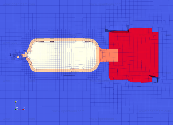

snappyHexMesh: location(s) in mesh
The process to define faceZones and cellZones in cases with bordering geometries has been extended. Firstly cellZones can now be assigned purely by walking across connected regions and are no longer related to a particular geometry. In other words they behave similar to locationInMesh, which is determined by walking all visible parts of the mesh. Secondly, faceZones are now automatically generated from each combination of cellZones. Faces that have neighbours in different cellZones will be allocated into a generated faceZone. The new behaviour is controlled through the locationsInMesh, locationsOutsideMesh and faceZoneControls entries:
// (Optional) points that should not be reachable from the
// location(s)InMesh. Meshing will abort if with an error message.
locationsOutsideMesh ((100 100 100));
// Points, one per region, and an optional name of a cellZone. "none" is
// the special name for the unzoned mesh region. Any face between different
// regions get added to a faceZone with name
// <cellZoneA>_to_<cellZoneB> where A is the lowest numbered
// cellZone.
locationsInMesh
((-0.09 0.001 -0.049) leftSolid)
((0.01 0.0299 0.01) none)
// (Optional) per synthesised faceZone, the type of baffles
faceZoneControls
leftSolid_to_none
// (Optional) specification of patch type (default is wall). No
// constraint types (cyclic, symmetry) etc. are allowed.
patchInfo
type patch;
inGroups (patchPatches);
faceType baffle;

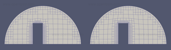

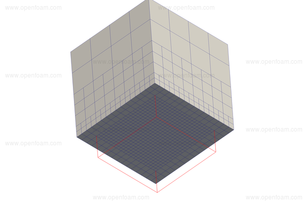

snappyHexMesh: refinement at coarse/fine intersections
The surface refinement level is currently cached by snappyHexMesh on a per-input-triangle basis by looking at the refinement level that each triangle centre would receive. This results in all cells that intersect the same surface triangle being assigned the same refinement level. For large triangles spanning multiple volume refinement shells, e.g. outside box of a wind tunnel simulation, this can result in sub-optimal performance.
In this version the logic has been updated to
- detect triangles where points and triangle centre would get a different refinement level.
- specifically handle these triangles during actual refinement and look up the needed refinement level from the actual intersection position.
This combines the performance of caching of the wanted refinement level for most of the triangles with the accurate refinement from using the actual intersection. On most surfaces the number of triangles which gets tested will be a small fraction of the overall number of triangles. snappyHexMesh will now display during startup the number of uncached triangles.
The same logic applies to non-triangle refinement surfaces, e.g.searchableBox, searchableSphere etc.. These will be refined according to actual intersection location. This means that the surface refinement level phase will already refine the surface up to the wanted shell level whereas before the wanted refinement level was only reached in the follow-on shell refinement phase. The effect is that now on curved surfaces, e.g.searchableSphere, the mesh that is kept better represents the actual geometry (if the refinement was due to refinement shells).
snappyHexMesh: volume smoothing
The snappyHexMesh procedure introduces uses a cell-splitting method to create finer cells. At the interface between coarse and fine cells this produces a non-orthogonality of around 30 degrees for an initial hex cell. This non-orthogonality can be improved by smoothing the mesh at these interfaces.
In this version, the points on faces where the refinement level changes can be smoothed. This new behaviour is switched off by default but can be enabled with the new nSmoothInternal setting in the snapControls section.

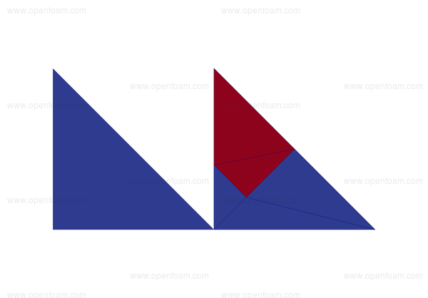

snappyHexMesh: splitting of boundary faces
The default behaviour of snappyHexMesh is to try to align existing mesh edges to features. This sometimes causes faces which are concave, which usually appear as non-orthogonality of the extruded mesh. This will limit the amount of layer coverage.
To avoid this scenario, new optional settings enable splitting of faces along a diagonal if the operation results in a mesh edge which better conforms to the feature.
The behaviour is controlled by the settings:
// When to run face splitting (never at first iteration, always
// at last iteration). Is interval. Default -1 (disabled)
// Recommendation: set to half the number of feature snap iterations
nFaceSplitInterval 5;
