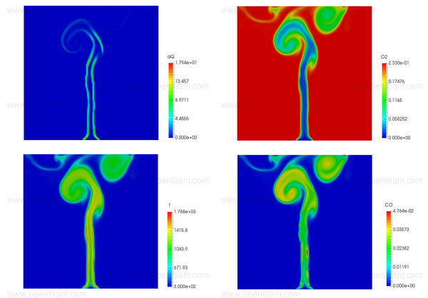

New Diffusion-based Turbulent Combustion Model
A new turbulent diffusion combustion model named diffusionMulticomponent for multiple step reactions has been implemented. The model assumes single a stream of fuel and oxidant for each reaction.
The reaction rate is based on the magnitude of the product of fuel and oxidant turbulence fluxes.
A finite reaction rate can be used to initialise the reaction rate, typically for lower temperature regions away from the mixing zone or during ignition using the laminarIgn option.
A normalised Gaussian distribution, centred at the stoichiometry value of each reaction, positions the flame in mixture fraction space. Users may specify the standard deviation of the Gaussian distribution. The probability distribution is moderated by a dynamic constant based on the amount of oxidant remaining in each reaction.
The diffusion reaction rate for k equation is given by:
where
is the effective diffusion,
the normalized Gaussian
distribution centred on the stoichiometry value, and
a dynamic model
constant, defined as:
where
is the oxidant remaining in each reaction (user input) and
a model constant with a default value of 1.
- Examples
- smallPoolFire2D: $FOAM_TUTORIALS/combustion/fireFoam/les/smallPoolFire2D
See note in file $FOAM_CASE/constant/combustionProperties in order to activate the model
The pictures show the results after 3 seconds of fuel injection from the bottom injector into the atmosphere for the flame front, shown by the heat release contour, and temperature contours.
