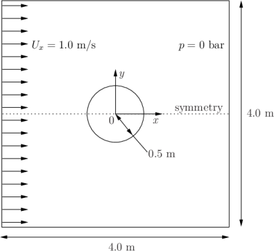

The problem is defined as follows:
- Solution domain
- The domain is 2 dimensional and consists of a square domain with
a cylinder collocated with the centre of the square as shown in Figure 2.15.
- Governing equations
- Boundary conditions
- Inlet (left) with fixed velocity
- Outlet (right) with a fixed pressure
- No-slip wall (bottom);
- Symmetry plane (top).
- Initial conditions
— required in OpenFOAM
input files but not necessary for the solution since the problem is
steady-state.

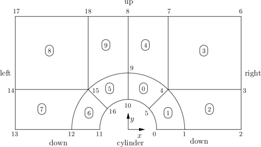

2.2.3 Mesh generation
Mesh generation using blockMesh has been described in tutorials in the User
Guide. In this case, the mesh consists of
blocks as shown in Figure 2.16.
Remember that all meshes are treated as 3 dimensional in OpenFOAM. If we
wish to solve a 2 dimensional problem, we must describe a 3 dimensional mesh
that is only one cell thick in the third direction that is not solved. In Figure 2.16
we show only the back plane of the geometry, along
, in which the
vertex numbers are numbered 0-18. The other 19 vertices in the front plane,
, are numbered in the same order as the back plane, as shown in the
mesh description file below:

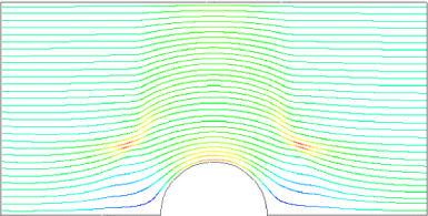

potentialFoam executes an iterative loop around the pressure equation which it
solves in order that explicit terms relating to non-orthogonal correction in
the Laplacian term may be updated in successive iterations. The number of
iterations around the pressure equation is controlled by the
nNonOrthogonalCorrectors keyword in the fvSolution dictionary. In the
first instance we can set nNonOrthogonalCorrectors to 0 so that no loops
are performed, i.e. the pressure equation is solved once, and there is no
non-orthogonal correction. The solution is shown in Figure 2.17(a) (at
, when the steady-state simulation is complete).
(a) With no non-orthogonal correction |

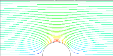

(b) With non-orthogonal correction |

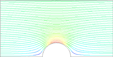

(c) Analytical solution |
We expect the solution to show smooth streamlines passing across the domain as in the analytical solution in Figure 2.17(c), yet there is clearly some error in the regions where there is high non-orthogonality in the mesh, e.g. at the join of blocks 0, 1 and 3. The case can be run a second time with some non-orthogonal correction by setting nNonOrthogonalCorrectors to 3. The solution shows smooth streamlines with no significant error due to non-orthogonality as shown in Figure 2.17(b).
